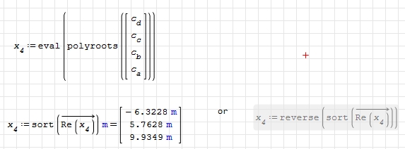

Usually polynomial roots sorting can't be done, just because they are complex numbers in the general case, and you can't define an order relation there. But forcing to get only reals, you can use sort() or reverse(sort()). The same could be done with the solve code at the end of your document.
Alvaro,
Thank you. Did not think about sort(), that would do the trick.

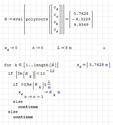

Is it possible to extract solution(s) from the vector that satisfies 0≤x≤L?
Hi. Sure. For instance can use a for loop, like in the attached.
cubic.sm (82.78 KiB)已下载 1267 次。
but I didn't quite understand why polyroots() doesn't sort its solutions. Any insight on that matter?
The problem is that the complexes cannot be ordered, so there is no standard about how to present the results.
However, since the roots of a polynomial are usually calculated as the eigenvalues of the companion matrix, and numerical procedures usually order these eigenvalues according to their magnitude, which is a real number, since it does have applications to keep the large eigenvalues and neglect the small ones, perhaps that is the order in which the roots appear in polyroots (): ordered by their complex magnitude, but I can't be sure, since I don't know the SMath routine for its calculation.

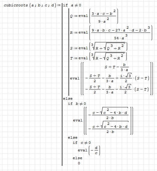

3. Would you trust polyroots() over someting like the cubic solver in the attached sheet? I want to use code that finds the solutions symbolically rather than numerically.

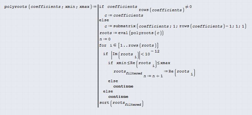

4. I should probably define a function that finds the roots of a polynomial that are within a range if I want to to this several times within the same sheet?

3. Your cubic is incorrect vs the conventional attached and Polyroots.

3. I don't know the internals of SMath polyroots(), but I'm pretty sure that can't handle symbolic values. And I'm pretty sure also that an application in civil engineering with symbolic expressions for cubic polynomials roots requires a very powerful symbolic kernel, and SMath isn't at that stage right now.
4. Sure, first use your cubic, which works well and it's equivalent to polyroots(reverse(stack(a,b,c,d)) and then define another for take only roots in the desired interval. Notice that in my procedure I assign x.4[n:=n+1] to R[k] but it's more correct assign to Re(R[k]).

I guess there is no reason to use my own code to solve polynomials when SMath has polyroots. The cubic solver from my last post was something I made before I discovered polyroots.
Re 4, does this look like what you would have made to serve this purpose?
