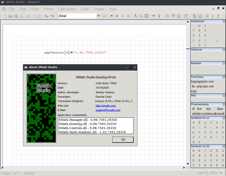

the PNG file has 2 colors (black and transparent black), however PNG format has alpha channel while GIF has just transparency. Transparency on black color might be the problem in mono?
On old button images alpha (transparent) color is white.
All colors are black on new images, even alpha channels.
If you make alpha channel as overlay all image is black.
Davide's suggestion could work.
Coloring alpha as white or another color can fix the problem.
Regards.

This is how it is on my setup.
Same as previous builds.

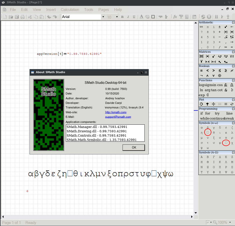

#29 已发布: 2020/10/15 18:37:10
600个赞,共1,381个帖子。
One more attempt: http://smath.com/file/mV3da
Please try and let us know if toolbox buttons are visible now.
All is working excepts those two characters.
Congrats, a long mystery is solved.
By the way, maybe that's just my linux setup but;
If I use only the keyboard for "Evaluate symbolically (Ctrl+.)" it is not working too.
Button is fine for calculation, just keyboard combination doesn't work.

Great! Thank you!
This is because of Font missing some Greek symbols. Please try to write these chars in TextRegion and test different Fonts for this Region. I'm sure you will find some Fonts which will allow to render all Greek chars correctly.

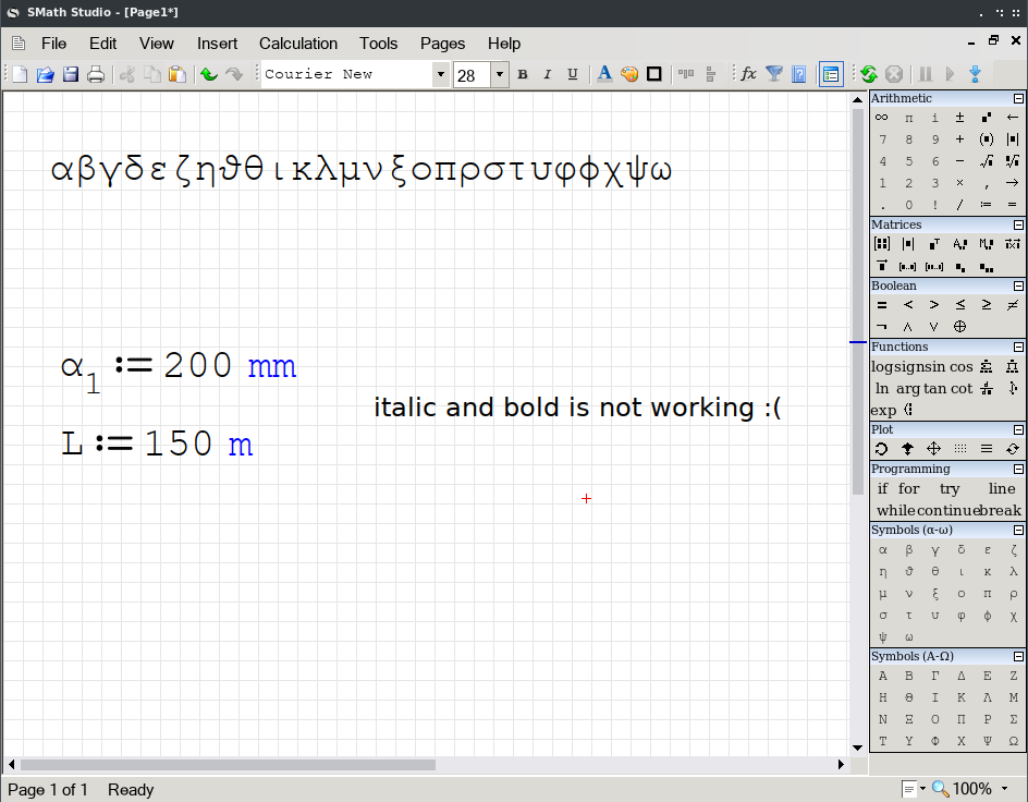

#31 已发布: 2020/10/15 22:08:47
600个赞,共1,381个帖子。
Great! Thank you!
Yeap, you were right. I have copied courier font from windows font folder to linux now everything is in order.
Apparently free courier fonts are missing some characters. (which had derived from a previous archlinux setup)
There is no font or sidebar issue now as you can see.
Well, because I have grumpy and complainer personality I have seen another problem.
Bold and italic (and combined) is not working also.
Expressions should be italic and greek characters above is bold actually.
You can see this issue at picture below.
Regards.
