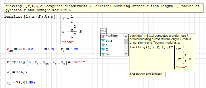

Casting the computations into block functions with no reference to context variables from inside removes any restrictions on variable names in the sheet. With a proper description such functions become self-documenting. This way you can create portable collections of such functions (and store them as snippets).
Blatt22.sm (5.76 KiB)已下载 1400 次。

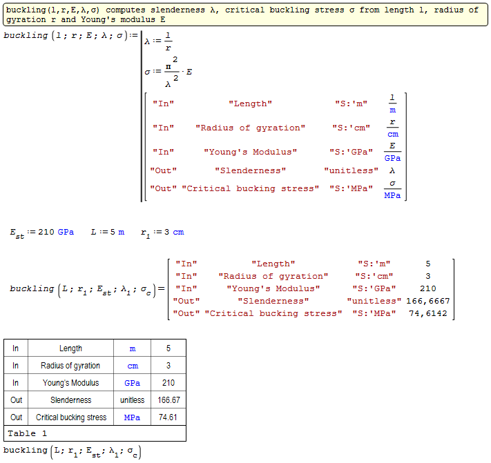

Here is a easy way to get a summary for procedural implementations of algorithms. You just insert a table region, write your function to the placeholder and do some format adjustments. In the example I just switched from fixed to variable width of table columns and set the font to arial.
Unfortunately, the decimal separator setting is not respected.
This procedure has full control over units in results display and can be extended to alvaros generalized approach (with then input and output flags being dynamic).
Blatt22.sm (12.98 KiB)已下载 1410 次。
