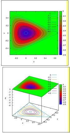

I tried to use the plugin Maxima
PlateMaxima.sm (143.87 KiB)已下载 1533 次。
Andrey Ivashov 2018/1/24 16:37:00, frapuano 2018/1/24 19:43:00
Thanks Ber7, I love those 3D, though it will never beat Mathcad 8... 11.
On my own, I published several times more than the entire Mathcad Community.
I don't miss them in Smath 6179, why ? purely useless for the Engineer.
They are just for the Gallery [Tom G. would say Peanut Gallery].
We are just waiting for a stable Smath version delivered with Maxima plugin
and more of the possible plugins. Scilab looks far superior to Maxima ?

Vibrations of a triangular membrane(Maxima)
TriangularMembrane Maxima.sm (279.28 KiB)已下载 1553 次。
