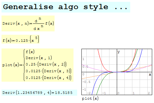

Is it possible to add more pleasing higher order derivative, like these ?
More Derivatives is limited by the symbolic of f(x)
More pleasant ... from invention.

...make it algo style for in-situ command line.
#4 已发布: 2023/1/9 13:19:06
983个赞,共6,866个帖子。
Maths Derivative GENERALISED algo.sm (9.37 KiB)已下载 1725 次。

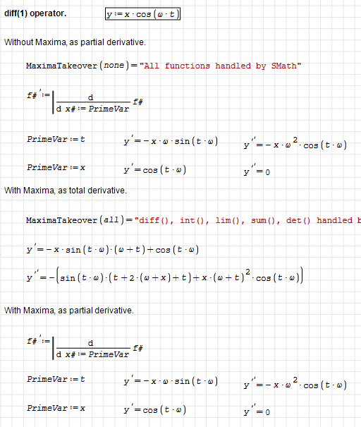

SMath has a built-in prime operator ()'. It can be created but will not be evaluated in the base configuration of SMath Studio
The Maxima plugin links this operator to the function Diff(1), which computes the total derivative of an expression with respect to all variables in that expression. You can mark symbolic constants in the expression by making them custom units (writing them with a leading prime like 'y).
The function Diff(1) is always avaliable if the Maxima plugin is installed, yet the operator form must explicitly be "hijacked" by the command MaximaTakeover().
It is then available as diff(1) in the dynamic assistant.
You can create second derivatives using nested ()' operators but that doesn't look good. Perhaps appropriate operators could be defined in the custom glyphs plugin.
diff1.sm (8.03 KiB)已下载 1807 次。

Hi. Some notes.
SMath has a built-in prime operator ()'. It can be created but will not be evaluated in the base configuration of SMath Studio ...
You can assign it to a partial derivative like operator inside SMath. (First example in the image)
... The Maxima plugin links this operator to the function Diff(1), which computes the total derivative of an expression with respect to all variables in that expression. You can mark symbolic constants in the expression by making them custom units (writing them with a leading prime like 'y).
Maxima is a great plugin. You can have it and prime as partial derivative, this is, it is not necessary to use units to mark variables other than the variable of the derivative. (Last example in the image)
diff1.sm (20.62 KiB)已下载 1796 次。
Hi Jean,
Thank you for the detailed examples. But how do you input the "n" on the top?

netsonicyxf
netsonicyxf
2个赞,共79个帖子。
@mkraska, @Razonar
Thank you for the exaples.
So I can use nested 1st order derivative to get higher order derivative.

Hi Jean,
Type n at bottom, top follows automatically.

983个赞,共6,866个帖子。
Maths Derivative GENERALISED algo.sm (9.37 KiB)已下载 1743 次。
