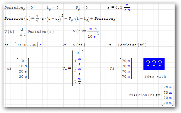

vector incorrect?
vector incorrect? - The values of the Pi vector, calculated for the previously defined function are invalid - 消息

However, by analyzing the individual values
any solution?

You must use the "vectorize" function to execute the operation element by element of the vector "ti"

any solution?
#5 已发布: 2018/8/16 13:42:30
983个赞,共6,866个帖子。
Cannonball project ...
Maths Cannonball Copy.sm (28.19 KiB)已下载 1344 次。
