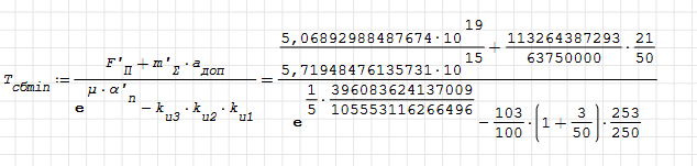

In the simplest case, this option would be suitable, but if the formula is a little more complicated, then we get a pile of fractions and numbers

Note: it has a little bit of a learning curve, but is worth considering never-the-less.
I don't see the result in the attached screenshots of how it works. A jumble of formulas where there is no clear answer.
