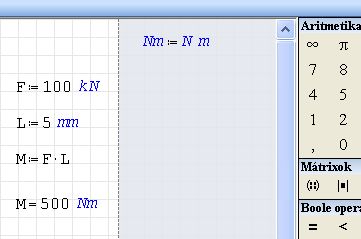

http://snag.gy/n4ZRf.jpg
Can anyone walk me through the steps for achieving the results in N*m? Isn't a major issue, but it would be nice to know how to do this.

Because you didn't enter the apostroph. In Kadpeter's example you have to type 'Nm:=N*m The apostroph will disappear and Nm become blue

@brotjob: That solved my problem, and my custom units are working more-or-less as I would like them.
