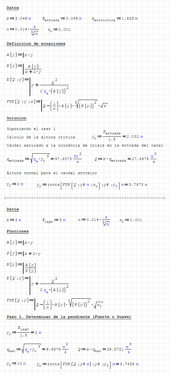

I need to pass these codes that are in Mathcad Prime to Smath, does anyone know how I can do it?

There is currently no converter from .mcdx format to .sm. And there is no one to do it, although it is possible.

I don't have the MCDX, I only have the pdf.
In this case, only manually.

But the programming is the same in Smath? I mean, for example the FYN or root function still works?
#7 已发布: 2021/12/20 16:08:32
600个赞,共1,381个帖子。
Not same, but very similar.

Smath has many solvers. FYN from implicit roots(,,,).
roots will solve on the canvas [MACH number]

Not exactly, not case of transit via local definition.

Not a case of local definition, crowds/confuses new Smath user
I have deliberately put to show as it will be calculated.
Variable can be named whatever user wants by the way.
I am sure Lelar is not confused, as he is a new user.

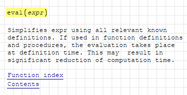

Is there a reason why Dy is within in eval()?
I tried removing it in the function and the result looks the same.
Two typos in your 'chito' document: Manilla, Kota Kinabalu in Sabah.
You are right, no need to Dy:=eval(,) is so fast.
eval(,) applies to parse result as a numeric entity.
It breaks the chain calculation. Per application experimental.
The rule eval(,) is crucifying ... watch the demo attached.
eval() makes computations faster most of time.
Very minor times, may have no effect or slows the calculation.
It would be wise to choose where and when to use it.
