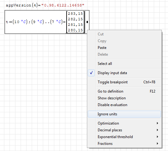

Units are lost in range(2):
С уважением, Михаил Каганский
Radovan Omorjan 2016/10/6 06:42:00
#4 Posted: 2016/10/6 06:40:17
I seem to be unable to use "[" shortcut to el() function.
Edit: The same for root ("\" )
Confirmed
#5 Posted: 2016/10/6 06:42:00
Confirmed

Problems with "[", "]", "\" and units in range are fixed in appVersion(4)="0.98.6123.7493"
