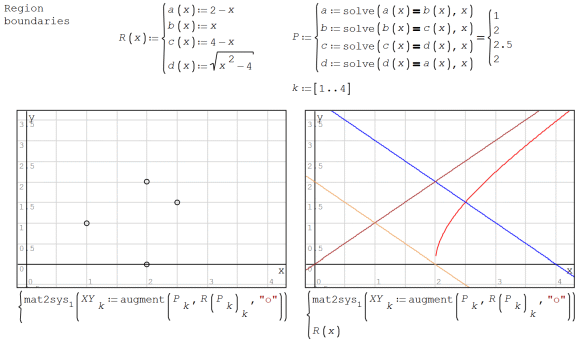

Hi. In the attached, can plot points and functions, but not both in the same plot.
Double Integral.sm (10.7 KiB)已下载 1346 次。

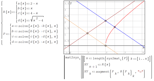

The old style works otherwise.
You can fill the region of integration.
Double Integral.sm (16.39 KiB)已下载 1353 次。
Double Integral FillRegion.sm (17.83 KiB)已下载 1308 次。

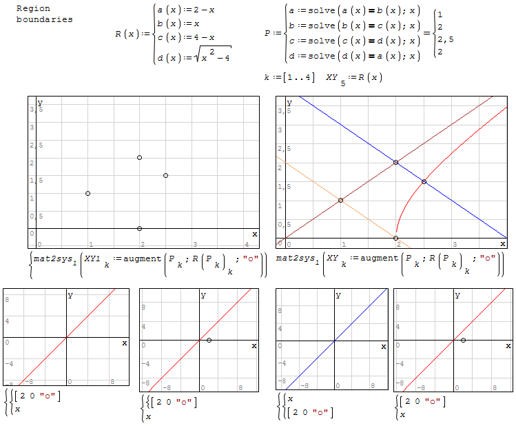

The behaviour of arguments in nested lists seems to be unpredictable, at least I don't see the rule.
Thus, re-arranging objects works but I don't know why.
Double%20Integral_Kr.sm (11.48 KiB)已下载 1521 次。

Hi Martin. Thanks for the tip. I guess that I take this form, from you suggestion:
#5 已发布: 2018/11/17 18:18:39
983个赞,共6,866个帖子。
... personally: I prefer the more conventional form.
The example in view may fail in other instance(s).
3 in one: functions, solutions, fill-in region.
X_Y Plot wisely [Solve] Boundary.sm (39.51 KiB)已下载 1187 次。
