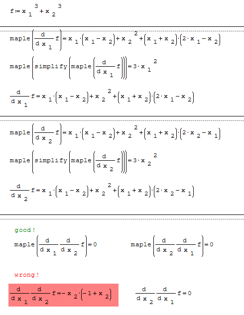

Hi omorr,
I confirm!
seem related to the symbolic simplification (see the attachments)
regards,
w3b5urf3r
derivatives_debug.sm (36.92 KiB) downloaded 1057 time(s).

I confirm!
regards,
w3b5urf3r
Radovan Omorjan 2012/7/31 01:55:00
It's the way SMath handles/prioritizes ASCII characters. I ran into a similar issue with MathCAD. In this case, the second variable of "x" (in the equation) has to be the first variable of the first derivative as shown in w3b5urf3r's screen shot.
