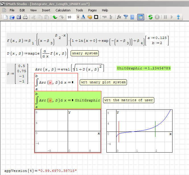

Hi Jean,
in which version did you prepare this example?
I use the last beta version, but I get a error 'x-not defined'
Thank you and best regards,
Andrey
#3 已发布: 2019/2/3 12:25:36
1,443个赞,共2,936个帖子。
It is probably because MapleTools returns β[#] instead of el(β,#)

"It is probably because MapleTools returns β[#] instead of el(β,#)"
Thank you, everything works without maple
