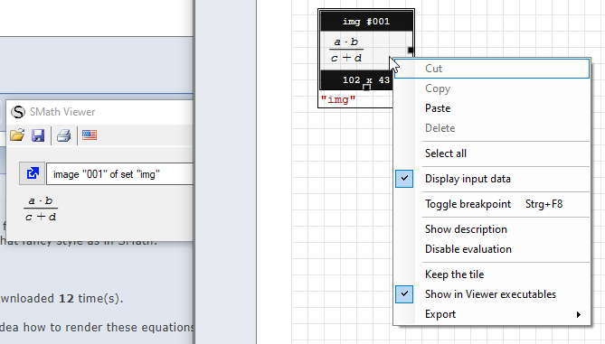

You can use a snapshot region, but it has decorations in the viewer which you might not want.

Thanks for the suggestion, but this technique evaluates any operation/number included in the equation, and I have equations with numbers that I don't need to be evaluated.

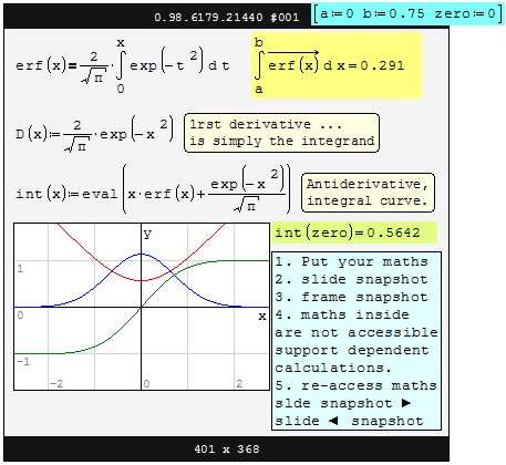

Similarly to X_Y plot, the background color of snapshot
is the active background color [any of 16777216 ... !]
