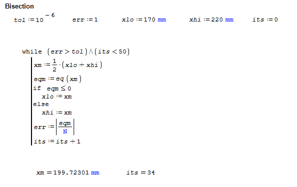

Here's a transparent, home grown bisection routine that does the job:
RC_forum_nonlinear_b.sm (79.46 KiB)已下载 1655 次。

Thank you! With your improvement the speed is significantly increased
