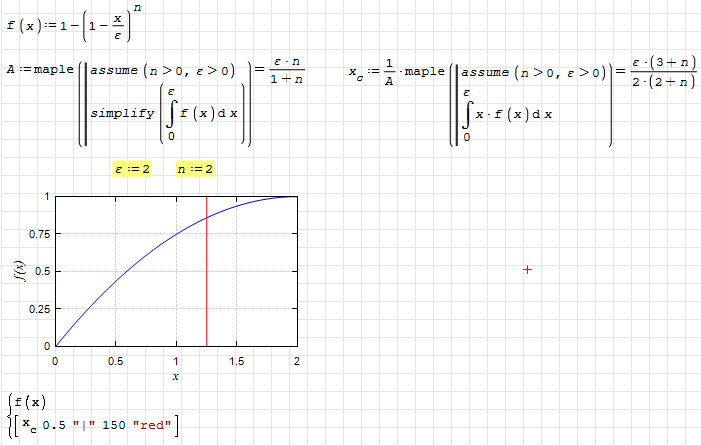

Here's my solution - done by hand, as it is straightforward using a simple substitution.

Area&Centroid.sm (13.22 KiB)已下载 1415 次。

Make your function parametric f(x,e,n), plot some typical.
f(x,0.5,0.5) ... f(x,0.5,2) ... f(x,0.5,3)
Discretize the range(s) of interest.
... suite for: Area, Perimeter, Centroid

Ac (uni).sm (8.4 KiB)已下载 1449 次。
#6 已发布: 2023/7/11 09:40:34
1,362个赞,共2,276个帖子。
Maxima is a bit lazy with simplification...
Ac.sm (7.08 KiB)已下载 1401 次。

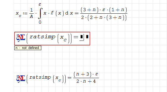

why can't i do right that?
what's the problem?
