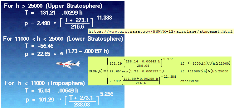

The NASA equations align very well with ASHRAE formulas once a sign error was fixed.
What sign error ? in ASHREA. NASA & OACI agree closely.

I had a sign error and could not get ASHRAE & NASA to converge. Take alook at the sheet preciously attached, the function is there showing VERY small differences for Troposphere calculations. Use either or both references.

* ASHRAE is NOT in aviation, it deals with air and compressed air. Air, at absolute (psia), is necessary for hydronic expansion tanks among other things.
* Never heard of OACI. You probably have aviation experience, not I.
* Most of us know you are not into units (gyzma). Many of us are and appreciate the fact that SMath, like MathCAD, assists in keeping things tidy internally. In this example, we see that NASA equation is in kPa, other references may be in Pa (like ASHRAE) or BAR. Unit's convert internally without a "lambda" gyzma correction somewhere after the fact that may be forgotten or missed.
* Heavy nighttime reading for later
BTW, the IP NASA equation solves for pressure in lbf/ft^2 (PSF) ... not the "more" traditional PSI. Plug in the function and convert the answer to PSI and WALLAH, more familiar units. Example: at sea level/zero elevation, 14.7 psi in lieu of 2116 psf.

Back on your topic. Based on my 3 yr old question on this forum (Thank you Martin), I revamped this file with the NASA equations. Modify the equation to the SI equivalent (in the closed area) as appropriate.
I will reiterate that pressure is linear, so "delta" is not required, similar to length.
3*m-1*m is 2*m (m = meters) in SMath, not 2 Δm. You can always "define" Δ pressure units to your requirement
Pressure a2g_g2a.sm (35.39 KiB) downloaded 1316 time(s).
