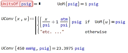

As workaround you can define your own convert function for show pressures, given that you know if a pressure x is absolute or gage:
Notice that UnitsOf returns an error for unknows units, but UoM works. Also I'm not prety sure if if that convertions is correct, but it's justo for show the idea about how to show abs or gauge pressures.
