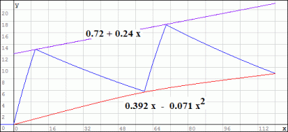

I need a little help with the following. I got the heating and cooling curves of an motor (see Picture1)
The Motor will heat up for 10min and then cool down for 50min. This over a specific time period, in the example 2 times. ->120min

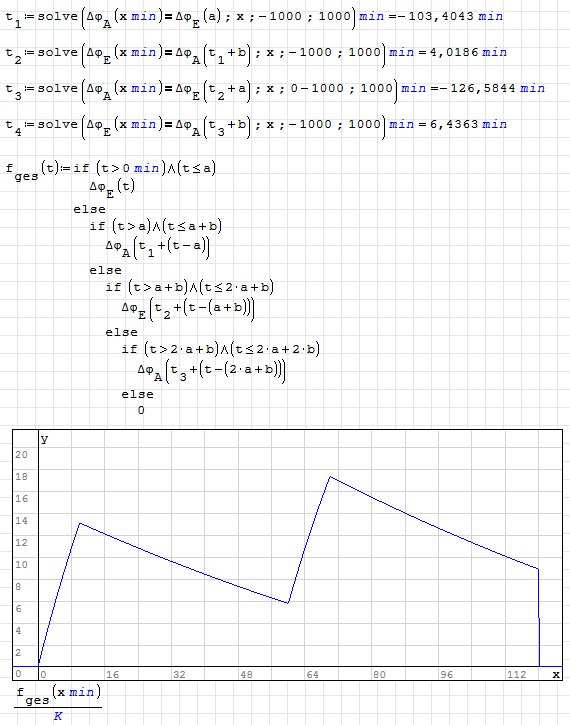

I tried to tie the functions together with the boolean Algebra as a continuous function. It works somehow but I do not get the solution I want to get..The do not connect since the second heating curve starts where the first stopped, not at the cooling curve(Picture 2)

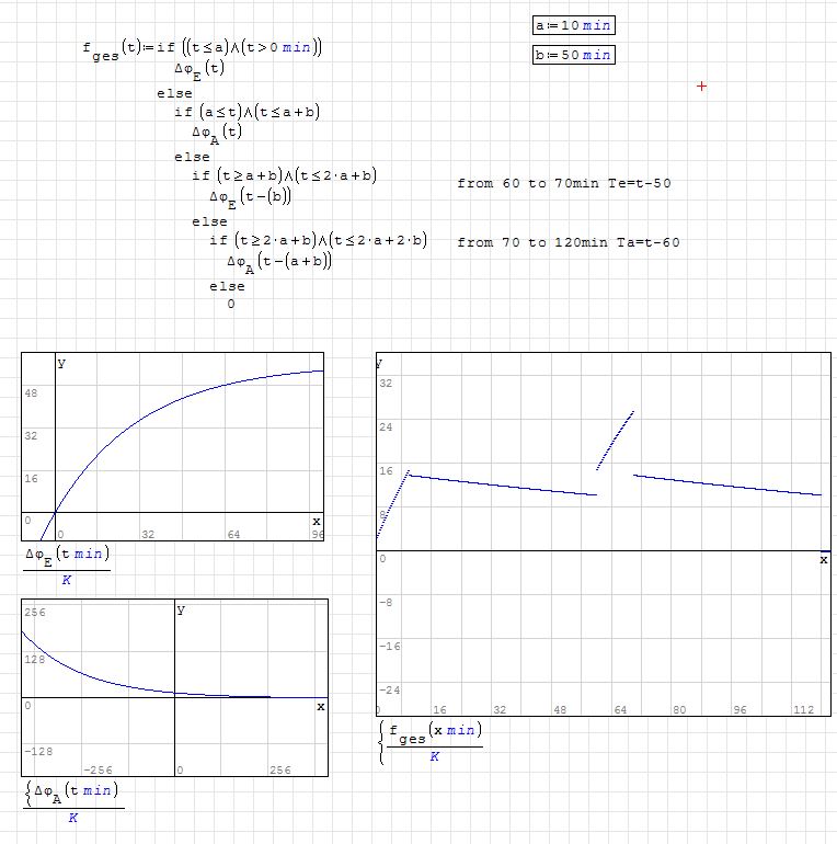

Where I am trying to get to is shown in Picture3 (blue graph).

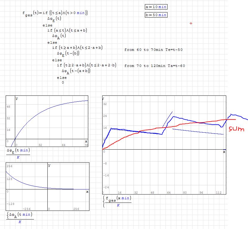

Furthermore I would like to Display a "sum"function in the graph. (Picture3) I have not thought about it yet but I do not think it is this easy with continuous functions. It won't be e.g. h(x)=f(x)*g(x)

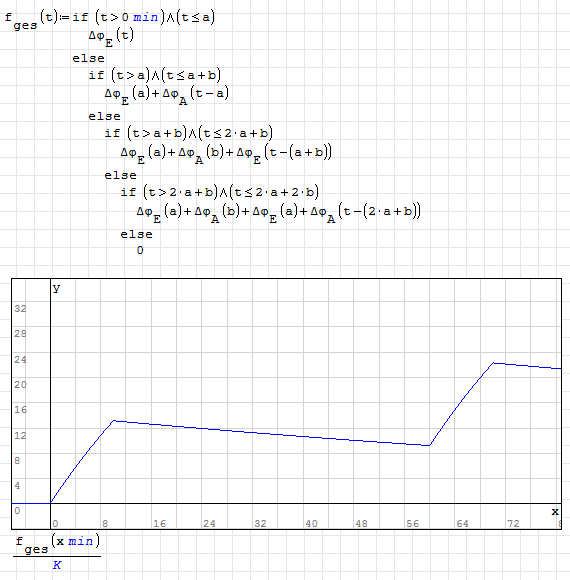

And by the way: cooling is not 15K*e^(-t/165min), but (-15K)*(1-e^(-t/165min)), or 15K*(e^(-t/165min)-1)
Actually, the resulting equation shouldn't operate times, but end temperatures of previous operation, to work as expected. My variant just literally fixes your implementation, but is physically incorrect.
Here's the one that's correct:
С уважением, Михаил Каганский

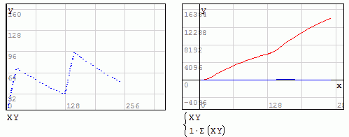

I noticed you have a plot. In case the finite differences
fails, apply the suggested change. If you have difficulties
to complete your project, please attach the work sheet.
#8 已发布: 2016/2/19 00:00:25
983个赞,共6,866个帖子。
Here is your Cumulative Integral. Everything is out
of proportion because it is based on your image, digitised.
The general look will not change from the real project.
