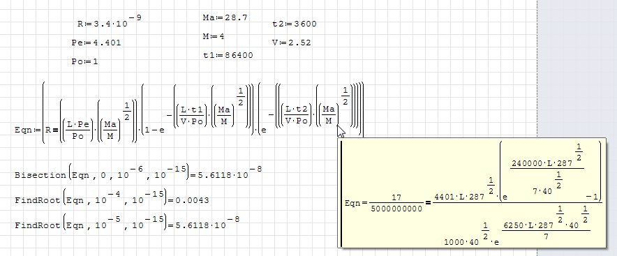

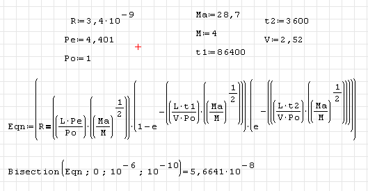

Here's a screenshot:
I know R from our mass spec measurements. I need to go back and find L (the actual leak rate of the device). There is no way to solve for L directly.
The answer for R=3.4*10^-9, L=5.612*10^-8... this is from a lot of work on my TI-85... I'm not 100% sure it's right...
Leak Rate Calculation.sm (6.29 KiB)已下载 1418 次。

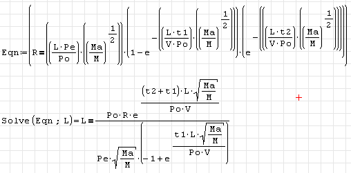

Thanks, I'm not sure this solves my problem. This looks like it rearranged the equation, but did not solve for L.
#5 已发布: 2014/1/18 04:22:04
1,362个赞,共2,276个帖子。
You are right, I did not really inspect the result, sorry for that. Here is another proposal.
#6 已发布: 2014/1/18 04:22:15
325个赞和1个踩,共2,052个帖子。
Martin suggests that you try to find L symbolically. Maxima returns L=f(L) which means that the function is nonlinear. Then you will go for a numerical solution. Numerical equations could be tricky. The best is first to try to plot it - to see the possible guess values and to see if there might be more solutions. See the pictures with the Maxima's L=f(L) rearanged equation and with your original (try to avoid so many braces - it is not needed). The second picture is with your original equation. This one is much more problematic for numerical solving. It seems that you need quite good guess value to get the second solution or you are going to get some value around zero, which is another solution (see the pictures). If you try to rearrange the eqaution is some other way, you might get no solution at all.
I do not know if this solution even have sense to you. There is another problem.
Leak Rate Calculation-1.sm (30.64 KiB)已下载 1320 次。
#7 已发布: 2014/1/18 07:46:10
1,362个赞,共2,276个帖子。
The equation has two solutions. Plotting the function f(L) is not very easy in the built-in plot region. Here is an example for how this can be done using the Maxima-Plugin. Not user-friendly either, but full control provided.
Leak_draw.sm (16.45 KiB)已下载 1398 次。

This awesome. I know for certain that the solution for L when R= 3.4x10^-9, is 5.614x10^-8.
So it appears there are many ways to get there. This is the first time I've used the program and I'm excited about all the possibilities. I'm going to try them all just to learn some more.
Thanks again!
