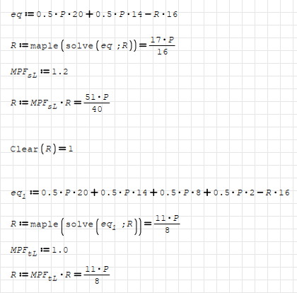

SMath Forum SMath Studio Questions Questions of solve function 1 Pages (2 items) Questions of solve function - Messages Go to last post #1 Posted: 2024/8/30 08:11:47 soomoon 1 likes in 40 posts. Group: User he first formula calculated well.The second formula did not calculate.The result is "The stack is empty."What is the problem?File not found.File not found. #2 Posted: 2024/8/30 09:18:59 overlord 597 likes in 1,377 posts. Group: Moderator Either clear R or use a different variable name, R.1 for example.Because you defined R at upper calculation, it confuses solvers.Regards 1 Pages (2 items) New Posts No New Posts
