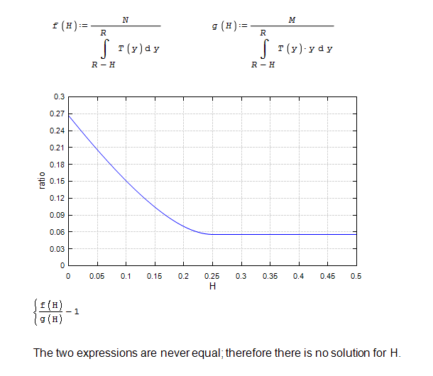

#6 已发布: 2023/7/17 04:37:53
StvMath
StvMath
44个赞和1个踩,共76个帖子。
There are no roots!
mod: image link fixed; please use the forum attachment function (paperclip icon ) instead of external services
Worksheet4b.sm (18.29 KiB)已下载 1374 次。
