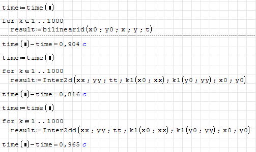

Here is a typical result on my computer (using your sample data). The results are consistently reproducible (±0.010s)
Notably slower is (surprisingly) Inter2dd, while Inter2d is steadily faster (though not that much faster - I suppose that further optimisation could give greater boost) than my variant. I wonder why these two almost identical functions work so differently in terms of performance?
I didn't test for corner cases yet. Also, larger tables should be tested as well.

ioan92 2014/2/21 05:02:00
As for me the fastest is bilinearid followed by Inter2dd...
Sometimes seems to me that performances are also affected by the position... if I place my InterBil on top or on the bottom of the list below I can see an high difference...
Thank you w3b5urf3r_reloaded,
here at home, I see the same results as you do. Seems that this is something machine-dependent...
Your "Limits" almost literally repeats "k1" by ioan92, but doesn't allow for backwards-sorted input, and for unclear reason restricts extrapolation. k1 is faster (partly because eval in "Limits" seem to slow it down a bit), and may be made yet (marginally) faster if the innermost loop is started from k:=2 instead of k:=1.
All the functions use different arguments passing order. I must say that I chose the original order to closely follow the *interp() family in smath. Well, except swapping rows and columns
Still, Inter2d is the fastest (on the computer I use at the moment) when used against a real matrix (23x13), with 6x speed gain over my bilinear.
The only "weakness" of it is that it cannot handle "unsorted" input, which should be extinctly rare. I suppose it's my choice. Thank you ioan92!

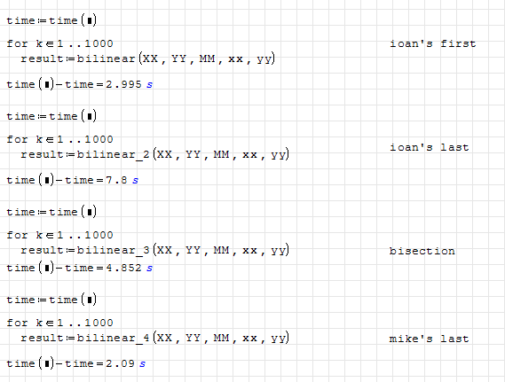

Well, as I noted earlier, I don't consider first Martin's suggestion efficient enough. It's beautiful, though, but it requires two passes of length(X): first to create matrix with ones, and second to sum them up.
Ioan's last variant improves it somewhat, but it still requires one full pass. In what sense is it superior to Ioan's initial k1()? It has no double logic.
OK, as exotic variants are considered here, I post my own, that I made after Ioan suggested his initial version of k1(). It is based on Ioan's, but removes doubling of logic. It won't have to iterate through all the vector, only the first part that is less (more) than lookup value. Still, it's less efficient than final version used in my post 7, because it uses extra function call.
margin.sm (4.4 KiB)已下载 1529 次。

A test through the Margin() solutions... BTW IMHO is preferable a test with less iterations but bigger matrices...
[edit 1] file updated (previously missing xx and yy values on the canvas)
[edit 2] screenshot updated using the file above
