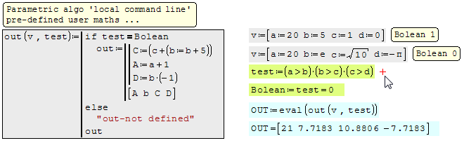

#2 已发布: 2023/4/6 19:44:47
983个赞,共6,866个帖子。
How can you write multiple conditions ...
If you want to piece wise plot conditional ...
if/otherwise ... as any as you want to condition.
From the directed visit Samples, iterative is bidirectional.
Or multiple conditional Golden ratio
More advanced conditional is generally Bolean... Example attached.
Show something of your Creation.
Cheers ... Jean.
