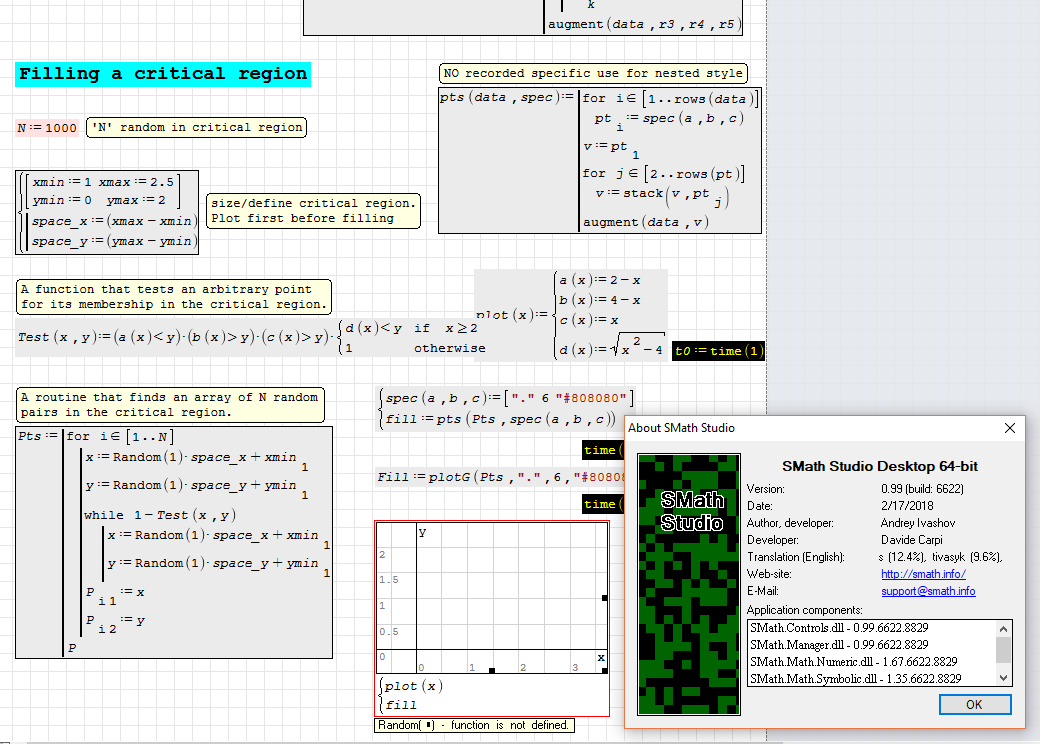

Jean,
It does not work in 6622.
In Graph: (does not display any graph)
Error: Random()= Function is not defined.
Thanks,
Basile
Thanks,
Basile

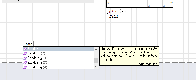

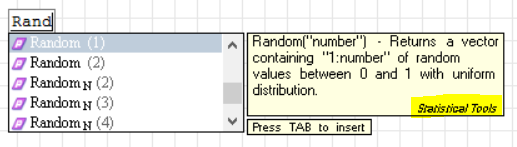

WroteRandom(..) function is from Statistical Tools plug-in. Please check if this plug-in available on your PC.

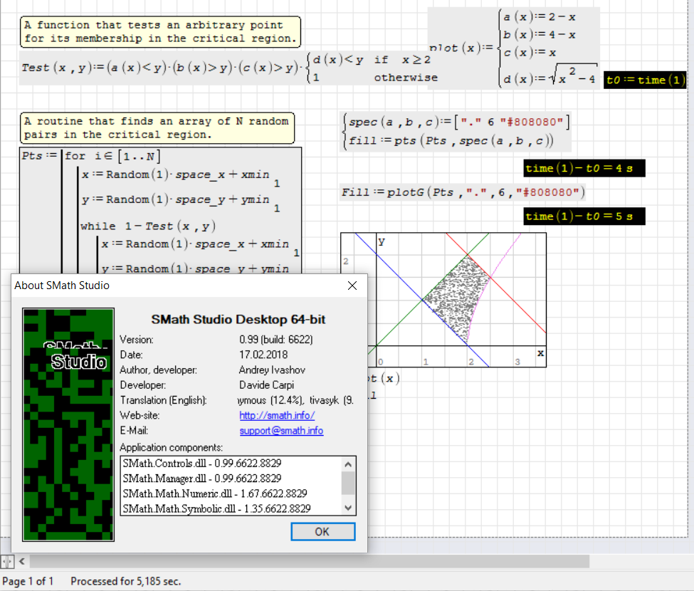

WroteJean,
I run your and I get:
Basile
Sorry mon ami, the "Grand Doctors" is the next step.
"Random(,) not defined" does not mean error from the plugin,
rather it means the program does not recognize from incompatible code.

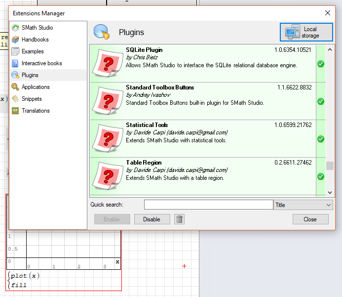

Not sure, but may be this is because of sort order of plug-ins or some additional plug-in which breaks the logic...

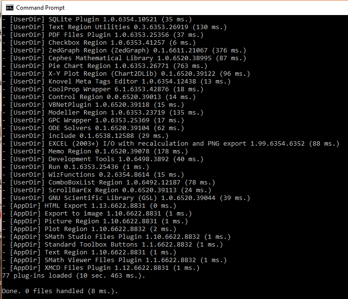

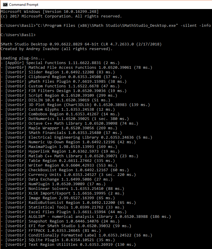

Please could you execute the following in command line? (path to SMathStudio_Desktop.exe may differ on your PC)
I would like to see the output of this command in order to try to reproduce this on my environment.
"C:\Program Files (x86)\SMath Studio\SMathStudio_Desktop.exe" -silent -info
Davide Carpi 2018/2/19 20:37:00
Thank you very much! Now I have everything to try reproducing this issue.
