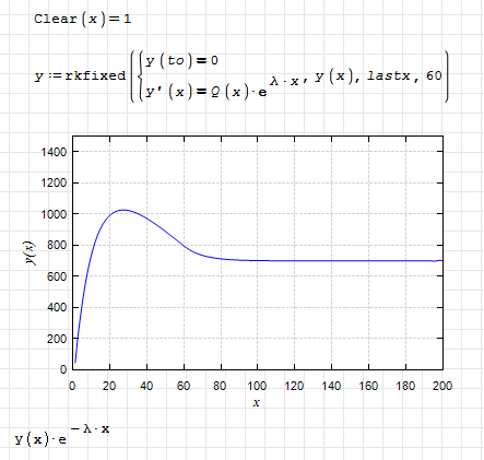

I suspect using 'if' function within Q(z) will not work for similar reason it did not work in these examples: https://en.smath.com/forum/yaf_postsm81767_Issues-with-cases-if-and-error.aspx#post81767
