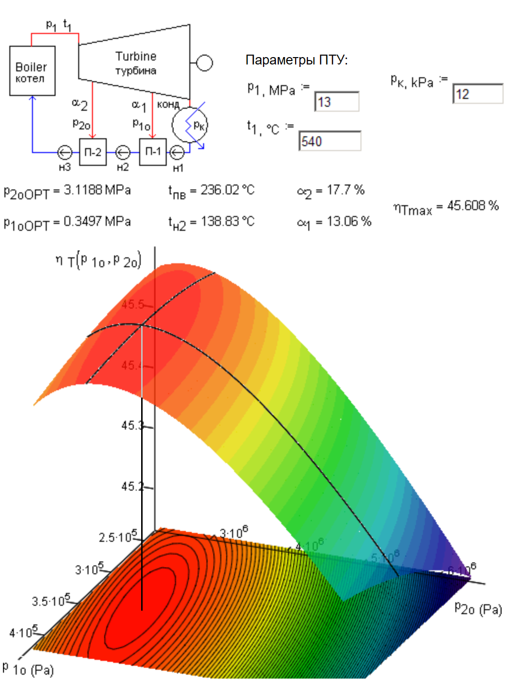

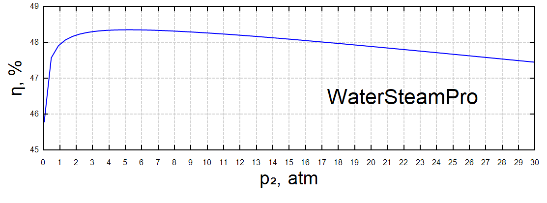

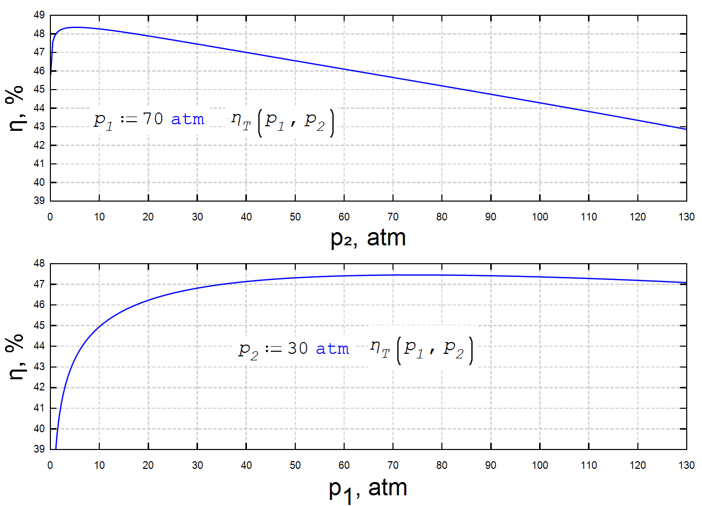

I have f(x, y) - thermal efficiency of a steam turbine with two steam extractions for heating feed water depending on the extraction pressures.
Question.
1. How to find the optimal pressure values at which the efficiency will be maximum?
2. Is it possible to build a surface? For now I have two separate 2D graphics.

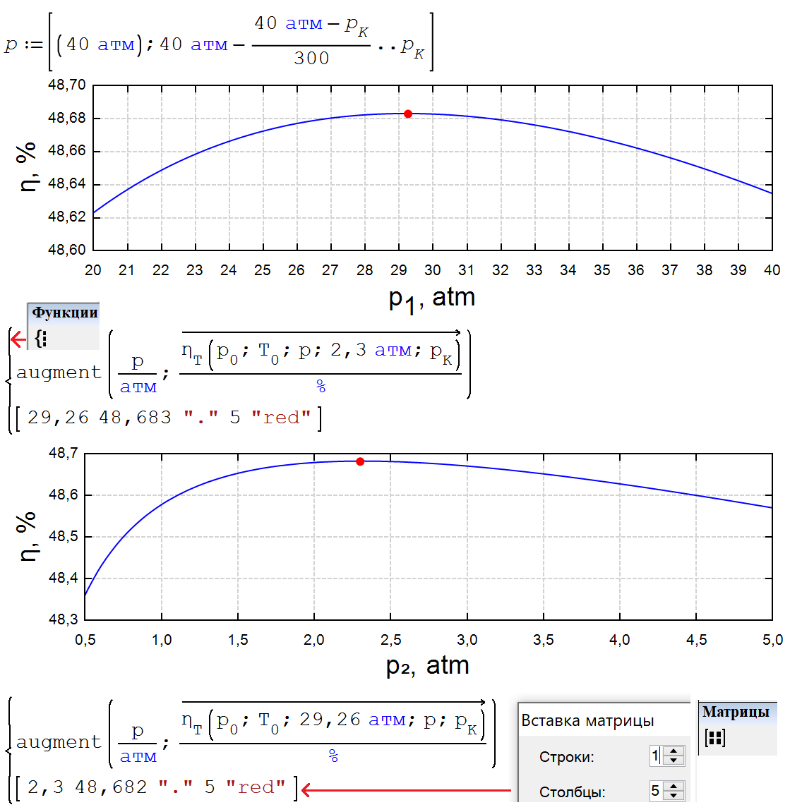

Martin (and all), I am waiting for the solution - 3D-plot and optimal values of p1 and p2.
Just the plot, no optimization yet.
![2023-11-08 15_08_23-SMath Solver - [2RegP-Ideal-Cool_Prop-95_Kr.sm_].png](/zh-Hans-CN/files/Download/KZD5C6/2023-11-08-15_08_23-SMath-Solver---[2RegP-Ideal-Cool_Prop-95_Kr.sm_].png)
2RegP-Ideal-Cool_Prop-95_Kr.sm (300.35 KiB) downloaded 1225 time(s).

... confirmed vs my formula IAPWS-97

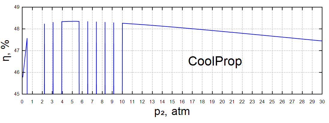

I get slightly different values. Still no automatic optimization because the objective function doesn't translate to Maxima. As a first step I made the function more robust by solving the two equations sequentially instead of simultaneously. In the original version sampling for the plot occasionally failed.
Plot MPa.pdf (219.47 KiB) downloaded 684 time(s).
2RegP-Ideal-Cool_Prop-95_Kr_detail.sm (157.12 KiB) downloaded 1256 time(s).

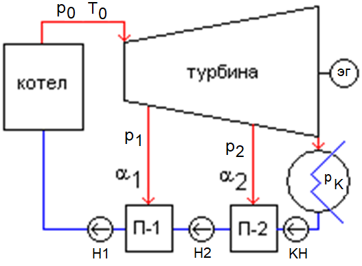

But I dare to note that a real steam turbine unit has up to eight steam extractions from the turbine to regenerative heaters. And not only mixing, but also surface type.

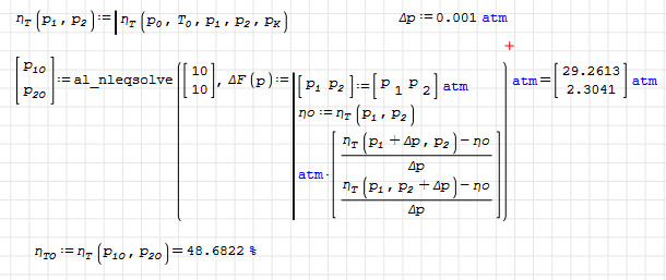

WroteI get slightly different values. ...

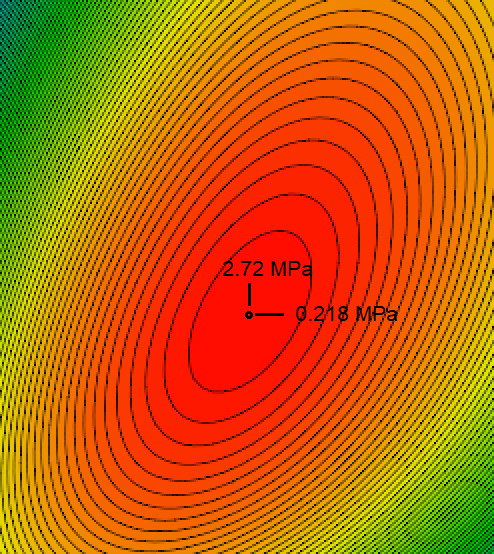

Hi. Using the definition for partial derivatives and a pure numerical solver.
2RegP-Ideal-Cool_Prop-95_Kr_detail.sm (162.36 KiB) downloaded 1189 time(s).
