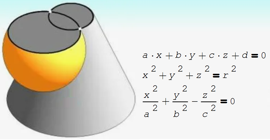

I want to solve three equations with three unknowns and display the solution on a 3D graph with two points - the roots of the equation.
Help please!

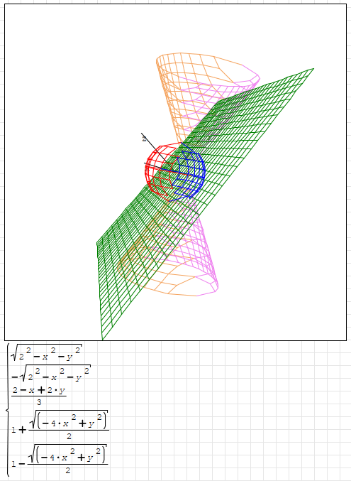

#3 Posted: 2024/2/20 23:02:25
597 likes in 1,377 posts.
Findroot() or roots() could solve three unknown systems.
About plotting, I simply wrote equations according to solving of z.
3Dplot_OchkovVF.sm (4.51 KiB) downloaded 1237 time(s).
Valery Ochkov 2024/2/20 23:05:00, Davide Carpi 2024/2/21 17:30:00

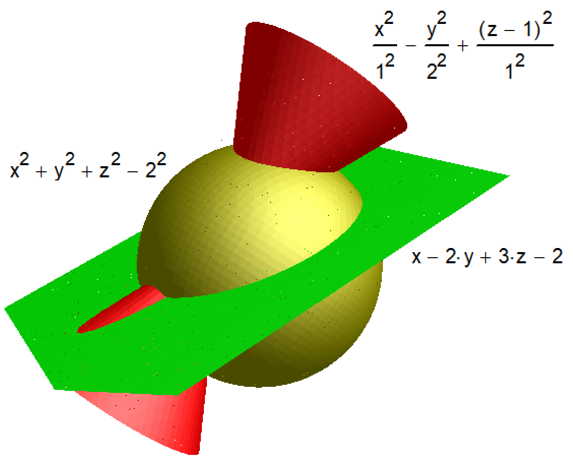

#4 Posted: 2024/2/21 06:54:08
1,353 likes in 2,264 posts.
3Dplot_OchkovVF_Kr.sm (329.75 KiB) downloaded 1326 time(s).
Davide Carpi 2024/2/21 17:29:00

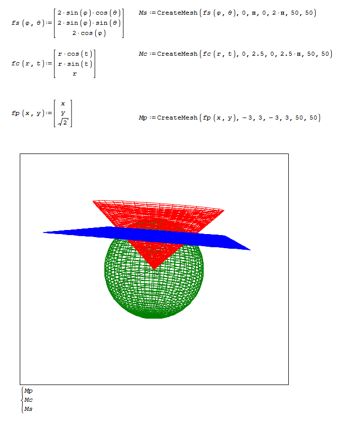

Like in the attached? (Though I confess it was a "suck it and see" approach as I don't fully understand the 3D graphing!)
TriangleSpherePlaneCreateMesh.sm (6.92 KiB) downloaded 1312 time(s).

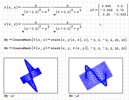

#8 Posted: 2024/2/29 11:56:27
1,106 likes in 1,784 posts.
Hi Overlord. If you can isolate some of the x, y or z variables, you can use this. If not, Viacheslav develops a 3D implicit plot codes for mathcad, you can see that somewhere in the mathcad forum.
create_mesh_xy.sm (8.42 KiB) downloaded 1309 time(s).
#9 Posted: 2024/2/29 16:46:48
1,544 likes in 1,859 posts.
The dots on the graphs above are a sign of my code being used.
I ask for a method converting a xyz function to CreateMesh() matrix.
This is only possible for simple cases if the function is easily parameterizable.
