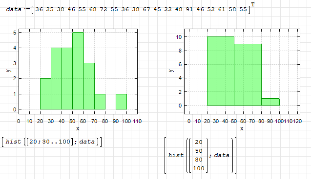

routine for X-Y plot
hist.sm (14.89 KiB) downloaded 999 time(s).

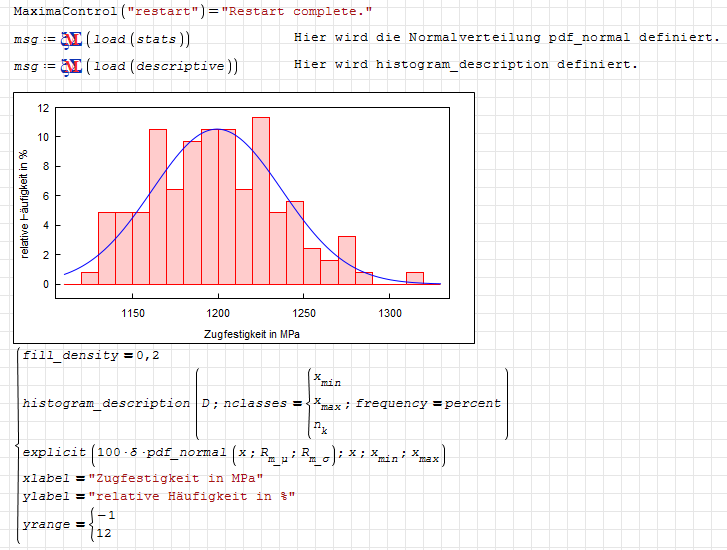

See Maxima docs for available functions and options
Streuung.sm (45.46 KiB) downloaded 979 time(s).
streug.rar (291 B) downloaded 270 time(s).

#9 Posted: 2019/1/13 20:48:58
This demo to illustrate the CLT
From native Smath, you can have:
1. colors at will [rich from X_Y plot], even white to imitate no bar.
2. Slightly separated, joined, slightly overlapped.
3. solid or hatched at will.
Stat Histogram BarColor.sm (26.33 KiB) downloaded 959 time(s).
