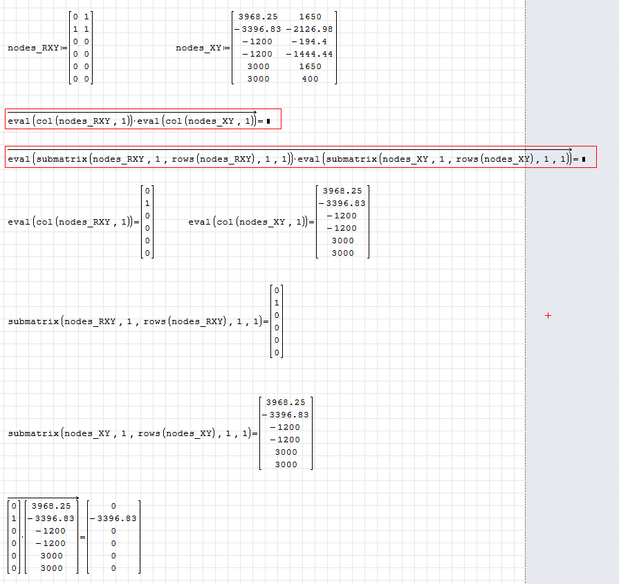

recently i found out about an issue with the Viewer, might it be possible to fix the update proces while using plugins like the comboboxList?
Please see the example pictures and you see the posibilities of the second list don't change
with the selection made in the first one, wich is non of a problem using
the file with SMath Studio... only with the Viewer it fails.
Thanks a lot for concerning!
I'd appreciate your help very much!

Sergio,
Your example that works elements wise, check for other issue:
vectorise as you did ... SQRT( ... result at the bottom of
the attached work sheet in light red.

What do you think Andrey to put then invert() function as well in the exception?
Function transpose() will get into the operator but invert() will not. Therefore, there is quite a difference between rising a matrix to a negative power inside vectorize() and having invert() inside vectorize(). For example, we have abs() and det() but inside vectorize() there is visually no difference.
I also hope this will not open some other issues regarding the vectorize() function.

Hello, Sergio.
[albumimg]1430[/albumimg]
Thank you for pointing it out.
From programmers point of view everything goes correctly here. You tries to transpose every single element of matrix, which is not allowed by the program (as transpose operation can be applied for matrices and vectors only). But on other side I see it will be very handy to have transpose operation in some exceptions list for vectorization.
Will check what I can do...
Best regards, Andrey Ivashov.
