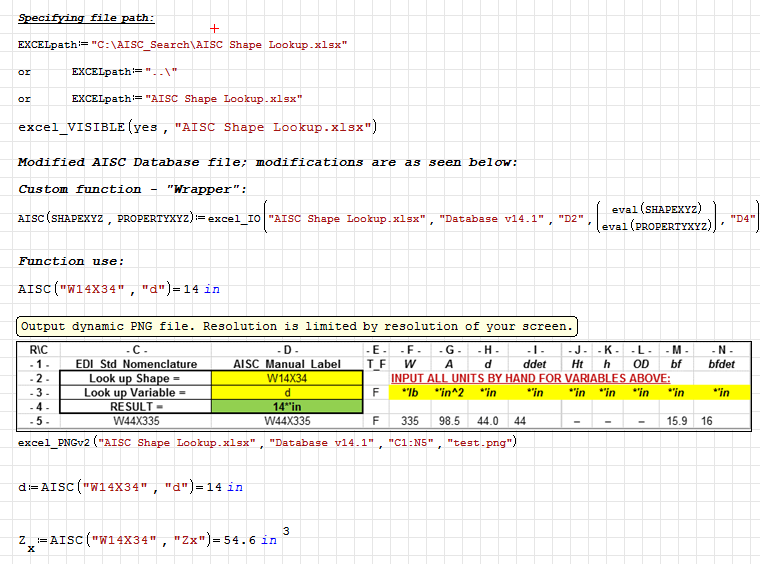

#23 已发布: 2015/12/5 15:31:22
Alexander O. Melnik
Alexander O. Melnik
127个赞,共498个帖子。
Not sure if I am grasping the root of the issue, but you can fairly easily write a wrapper as a smath user defined function using excel_IO. One would think that this way you can write a wrapper for any custom .dll for EXCEL.
All I have done was creating a simple Index(Array,Match(),Match()) lookup in EXCEL (with proper implementation of SMath units), and used excel_IO to work with it.
Seems to work very fast.
As always - please test for bugs and use at your own risk.
P.S.: Update excel plugin for proper handling of cell error values
AISC Shape Lookup.xlsx (3.27 MiB)已下载 1930 次。
Steel Properties Look-up.sm (20.36 KiB)已下载 1441 次。

Alex I appreciate your efforts with this.
I seem to be having a difficult time trying to use the "function/wrapper" inside a function.
My goal is be able to define a larger number of variables as quickly as possible. Lets assume that I need to define all the section property variables inside SMath in order my calculation to work properly. I like to establish these properties inside a function for two reasons - 1) it helps prevent variable definition overwriting. 2) I can call it many times through-out the page.
Ultimately I would set up an Smath page with multiple beam designs on the page.
Here is the condensed version of my issue:
Steel - Property Lookup Test.sm (29.71 KiB)已下载 1303 次。
AISC Shape Lookup.xlsx (2.91 MiB)已下载 989 次。
Here is what I'm working towards:
Steel - Function - WF Design.sm (84.79 KiB)已下载 1365 次。

While I am uncertain what would the the best approach to this problem, I am dedicated to make my excel plugin work as intended.
To RFreund and SinneD:
It seems that when my plugin is called inside a programmed function it has a difficult time identifying the working directory on its own. See a work around attached (define absolute path by concatting workingdir() and xlsx filename). I might try to pinpoint the bug if I have time - use the work around for the time being.
To ioan92:
I would much appreciate if you could let me know why the plugin does not work for you - again I am dedicated to fixing it if necessary. A good starting point is to delete and redownload the plugin from extension manager - it is still work in progress.

First of all I would not want to take credit for something I have not done - it was RFeund who created the majority of the SMath workbook you were looking at. I just helped him to make it work as he intended. So I will leave it up to him to incorporate first of your two very relevant comments.
Small note though - the latest version of the plugin (0.2.0.28218) should import values with units from excel. Those units can be converted to inches as per usual SMath operation:
I will want to learn how to use combobox plugin - I beleive the worksheet you attached earlier is a good guide :-)
