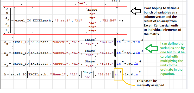

So this is proving to be more challenging than I imagined.
I think I can do what I want with some judicious trimming and logic. But I need a little help...
1. Symbolic optimization for importing data from spreadsheets: Does this matter if some of the entries in the cells are text entries?
2. Finding the right row is a challenge. the vlookup function would be what I would use in Excel to find the right row. Once I can get to the right row, I can extract the column that I need.
My challenge is getting to the right row in an efficient manner. Once I can get to the row, I can make the definitions that I need.
Thing is how do we 'find' the row efficiently?
Dennis

Ryan-
I am curious as to why you are taking the approach of vlookup? you will need to know the column for the info that you require- a bit risky because if you are off or something changes, the reference you are relying on can change.
Alex- I will update my plugin and try your suggestions.
Can you think of a way to do column vectors with ordinates and units? For example I want to define the following variables as a column vector in SMath, then pass to Excel, do some work then bring the resulting values back to SMAth to do more work. It would be advantageous to be able to have units built in.
For example the 6 row vector defining variables for shape size, area, weight, and 3 physical properties.
Shape
A
W
Sx
Zx
Ix
Pass that 1x6 array to Excel.
Excel then uses the first argument to find values for A, W, Sx, Zx, and Ix.
Return 1x5 that to SMath. As a single operation it works.
But when I try to use it to define variables, then it gives me a syntax error.
Shape
A
W
Sx
Zx
Ix
未找到文件。未找到文件。未找到文件。
WroteFor example I want to define the following variables as a column vector in SMath, then pass to Excel.
The calcbook you attached actually does do it. The issue here is that you are trying a "nested" definition of variables. You can assign the output from EXCEL to a single matrix "A" but you cannot assign very same output to a matrix of undefined variables.
What you can do is to use function el(), say variable:=el(A,1)

Alex-
You replied as I was editing.
I though that we could define a group of variables as a column vector. Now that I try it I see that it does not work...
That is the last bit of the worksheet that I posted.
EDIT: i am still trying to figure out the PNG function of the plugin.
