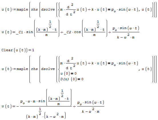

Symbolic results from ODE.sm (9.74 KiB) downloaded 1260 time(s).
Thank you. How do you input ",u(t)" in the brace?
I think so
dsolve( , u(t))

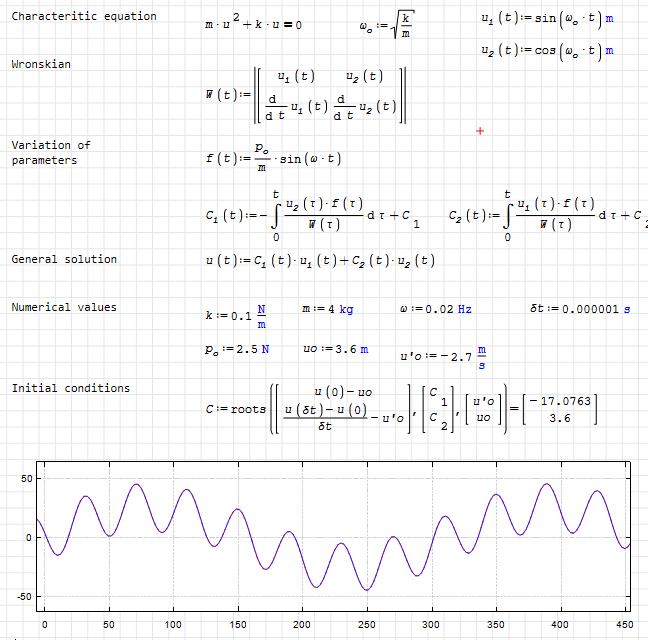

Plugin less solution, with units, using the Wronskian and the variation of parameters method.
Symbolic results from ODE.sm (23.52 KiB) downloaded 1215 time(s).
