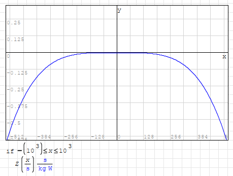

Plot of functions having big range on Y axis - No plot when trying to plot functions having big range - Messages
and I'm not able to obtain a plot of the function nor even dividing the function by
1E+10 - I suspect a pb dealing big numbers - by the way I have also an error trying to use MAXIMA GNU.
Has anyone some idea/workaround?
Many Thanks

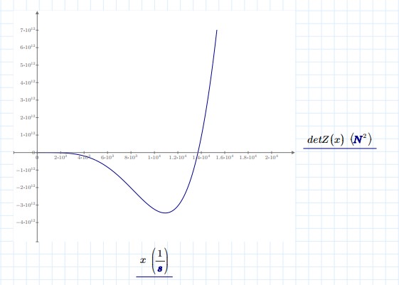

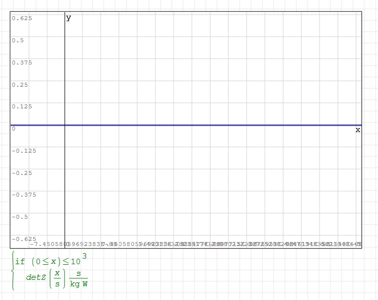

thanks for your quick reply.
Here attached the file so that you can see "hands-on" the issue.
For TMMT.sm (99.5 KiB) downloaded 1384 time(s).
I still suspect a limitation in plot function dealing with "big" numbers....but even dividing by 1E+08 (and even more...)
seems to work in this case (I made some other tests and, sometimes, this trick is useful).
As you understand I need a "visualization" of the function in order to "guide" the "solve" function (that seems
to work remarkably well w.r.t. MathCAD, by the way....but I cannot always be so lucky in this kind of problems...).
P.S. for mkraska
1) the name of detZ is, maybe misleading....in facts detZ calculate the determinant of a reduced matrix...and in any case
the function detZ(x) is defined directly by 4 functions
2) As you can see I can easily calculate the values of detZ(x) and find roots....BUT no plotting at all. By the way, due to complexity
of the function detZ(x), this last cannot be written explicitely....
3) I have difficulties to use Maxima for plotting (an error indicates that maxima.bat is apparently lacking in my -free- installation)...and, on the other side, I'm not allowed to install a new version of SMath without IT-manager support (he's actually in holydays...)....so, for the moment at least, no Maxima...
Last but not least: I'm a beginner (I discovered SMath 6 months ago and then I used it intensively, it's true) hence is possible that the way I have tackled the whole pb is not the most efficient (hence my issue with plotting...); so any suggestion, even completely changing the SMath sheet structure is welcome.

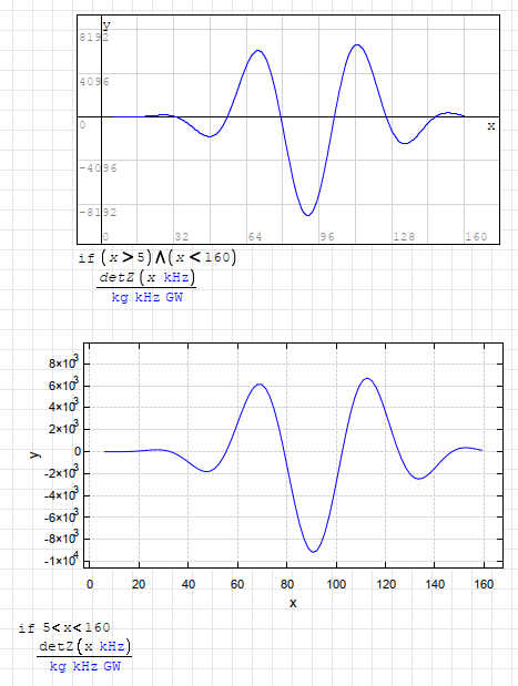

many thanks once more, as I have both solved the problem and, most of all (for a beginner like me), learnt something more...
In any case, it seems to me that each SMath installation has its own combination of "tricks" working (or not working...).
For Overlord, don't bother with my further question on range definition, I have found in the meanwhile....but still not working (see below)

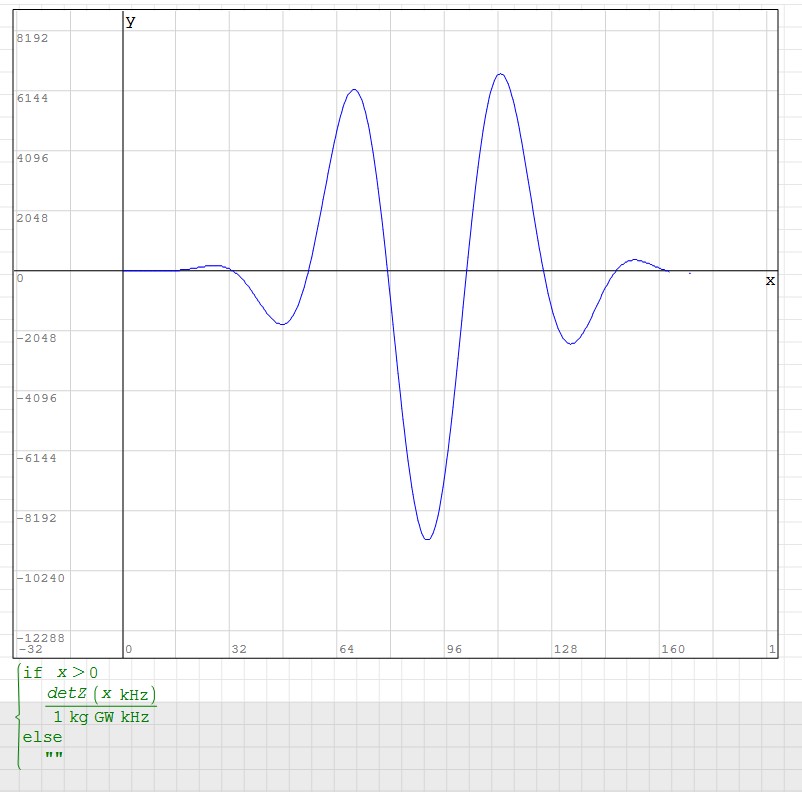

But once I combine the use of Plot native SMath function with unit scaling and range definition (as suggested and worked out by Razonar) and range definition...it works both with SMath native plot and with XY plot!!

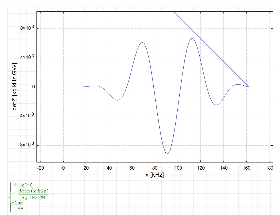

More, I tried to plot (with XY plot) the function for values higher than 160kHz; and, yes, something strange is happening for (see below); the same seems not using SMath Plot functionality
In my specific case, at least, frequencies over 160 kHz are not so critical (the lowest ones are the most worrisome). So, for the moment as said, my problem is solved....next step is to further complexify the function detZ (Omega)...

WroteMore, I tried to plot (with XY plot) the function for values higher than 160kHz; and, yes, something strange is happening for (see below); the same seems not using SMath Plot functionality
I asked that phenomenon to uni (author of XY Plot plugin).
It is caused by an algorithm to speed up plotting process.
If it really bothers you (it bothers me), there is a trick.
You can eliminate it by setting different start and end parameters.

For Overlord: what you propose, works but....have a look here below.....File not found.File not found.
The function seems to me too complex to make a study of the function (I mean limits, derives, max, min); but I'd like
to perform such a study 'cause I expect an "asymptotic" behavior for values higher than 162kHz (last zero)...maybe it's
this asymptotic behavior at the basis of the "strange" plot.
