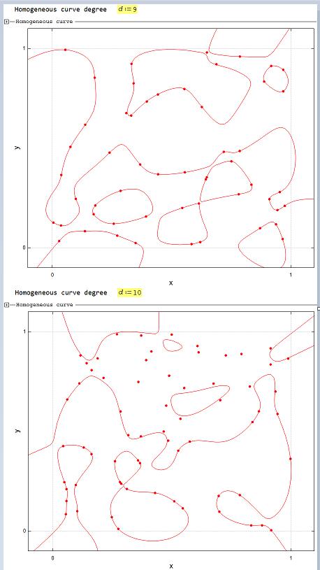

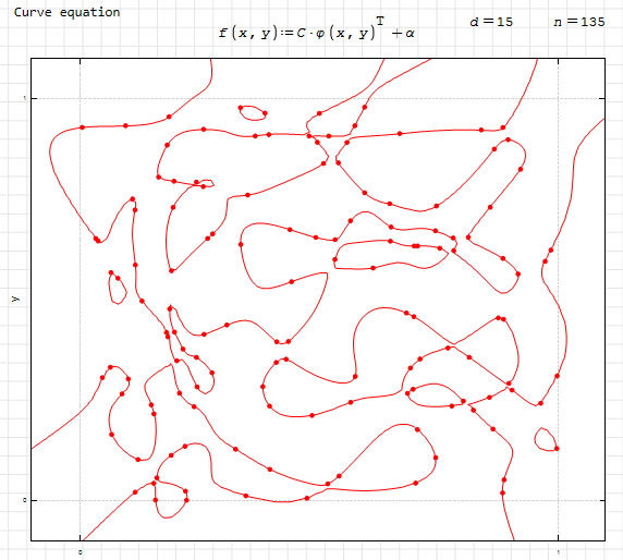

Yes, that's the sequence. It is the number of coefficients that have a homogenous bilinear form in two variables. And is the number of rows in the matrix 'v' in the file.
WroteLimit at n=10
I put the comments backwards. For big n, disable the SMath matrix inverse method and use dn_LinAlgSolve.
Homogeneous Curve.sm (31.07 KiB) downloaded 1125 time(s).
I suppose it can be easily generalized to three dimensions, except for the part of graphing the surface, since there we would not have the usefulness of XYPlot to graph implicit functions.

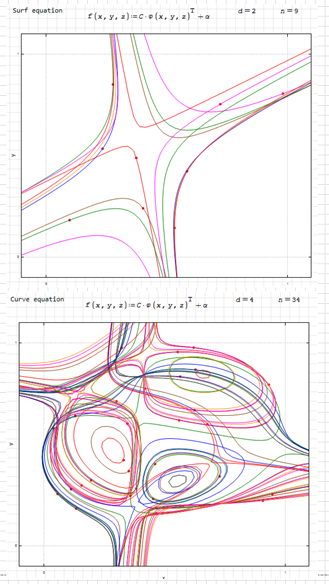

WroteI suppose it can be easily generalized to three dimensions, except for the part of graphing the surface, since there we would not have the usefulness of XYPlot to graph implicit functions.
With n level curves, one passes through each X,Y pair at level Z. For d=1, we have a plane, d=2 a quadric, etc.
Homogeneous Surface.sm (33.63 KiB) downloaded 1190 time(s).
