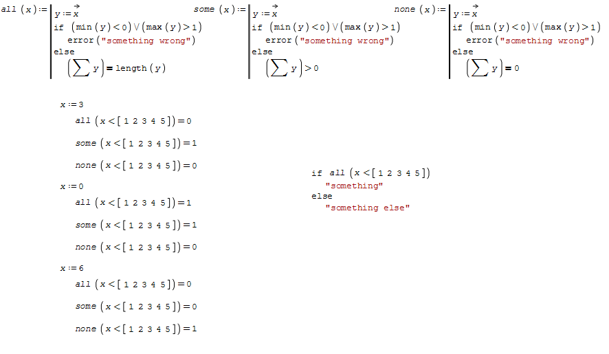

sergio 2022/5/9 12:46:00
1 Pages (7 items)
![2022-05-09 13_37_05-SMath Solver - [some all none.sm_].png](/zh-Hans-CN/files/Download/zxmznX/2022-05-09-13_37_05-SMath-Solver---[some-all-none.sm_].png)
