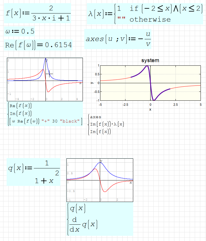

How to do it in SMath?

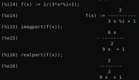

Natively, I don't know how it can be done.
Possibly you can't because smath symbolic engine is inferior.
Maxima can solve it. I assume maxima plugin can solve too in smath.
Maple plugin couldn't solve, maybe there is a trick I don't know.

As suggested ... remembering Imaginary is the Derivative
Worksheet104.sm (9.66 KiB)已下载 1630 次。 ... Please, let me know if working ... Jean
#4 已发布: 2024/2/13 02:14:07
600个赞,共1,381个帖子。
If anything you posted is related with question,
If any of your replies contains tiny bit fraction of correct answer,
It would be a miracle.
NO, IT IS NOT WORKING BECAUSE IT IS JUST A PLOT.
This is what Jean posted!!!

#5 已发布: 2024/2/13 03:58:14
1,362个赞,共2,276个帖子。
Maybe, Re() and Im() are worth adding to MaximaTakeover? Yet wrapping in Maxima() does the trick for now.
ReIm.sm (3.95 KiB)已下载 1588 次。

I assumed so!
