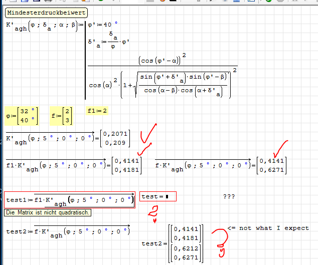

Please have a look a the following example:
The first two results look good.
But why assigning the formula to a variable not work?
And the result test2 doesn't look right, does it?
vectorize.sm (11.66 KiB) downloaded 1069 time(s).
Thanks for your help!

#3 Posted: 2017/4/16 06:46:10
Martin_B
Martin_B
22 likes in 84 posts.
Result is same as if done by hand.
Probably I don't really understand how vectorize works.
If _I_ would do it by hand,
  • I take the first element of "f" and the first element of "phi" (the two vectors in the expression)
  • I calculate the result and put it as first element in a vector
  • I continue with the the second elements ...
  • I would obtain a two-element-vector
that's what I get by evaluating the expression
vectorize(f*K.agh(φ,5*'°,0*'°,0*'°)
I don't understand why it's a different result if this expression is assigned to a variable.
If the first factor within vectorize is a scalar, the error "Matrix must be square." is shown. But again only if the expression is assigned to a variable.
Everything works fine with functions without the line command. (But it's not possible to to do it without line in every case.)
vectorize2.sm (15.8 KiB) downloaded 1051 time(s).

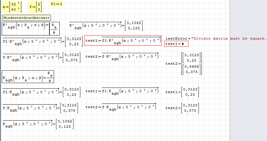

#4 Posted: 2017/4/16 09:42:18
The problem is in the function definition with or without line environment (as you already noted), and using the function call inside vectorize. See the picture please.
It might be a bit peculiar (maybe a bug) but one should be careful about it. It is advisable to assign the values to variables first and then to use vectorize (not to use function calls with vector arguments inside vectorize). Anyway, your gave an example where one can be easily confused.

#7 Posted: 2017/4/24 12:26:05
1,441 likes in 2,932 posts.
Found another strange behavior (as I think):
Shouldn't vectorize handle 1-element vectors like any other with more elements?
It should. I think I can fix it, thank you (see BTS SS-2443)
As for the initial problem, I tend to consider it a bug/issue, simply because what you get when the function is on the left side of an evaluation is not what you get when the function is on the right side of an assignment.
