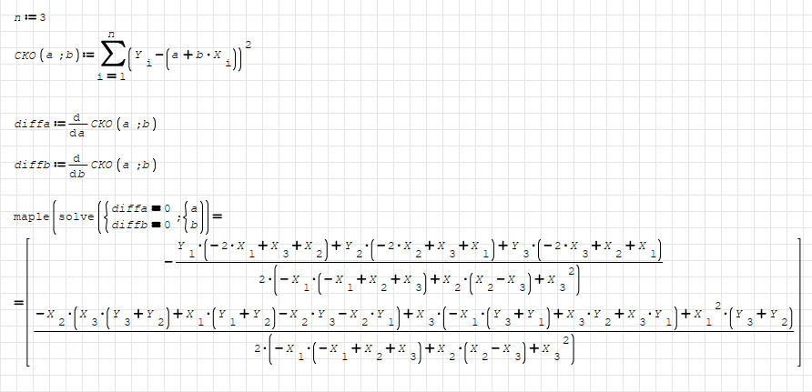

Hi. This is a way.

Valery Ochkov 2023/7/9 03:51:00
WroteHi. This is a way.

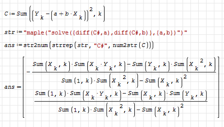

Thanks!
But what is it?
1 C:=Sum...
2 ans:=...
Wrote...
Thanks!
But what is it?
1 C:=Sum...
2 ans:=...
It's a maple component from the maple tools plugin. You must to have it at the insert menu:
