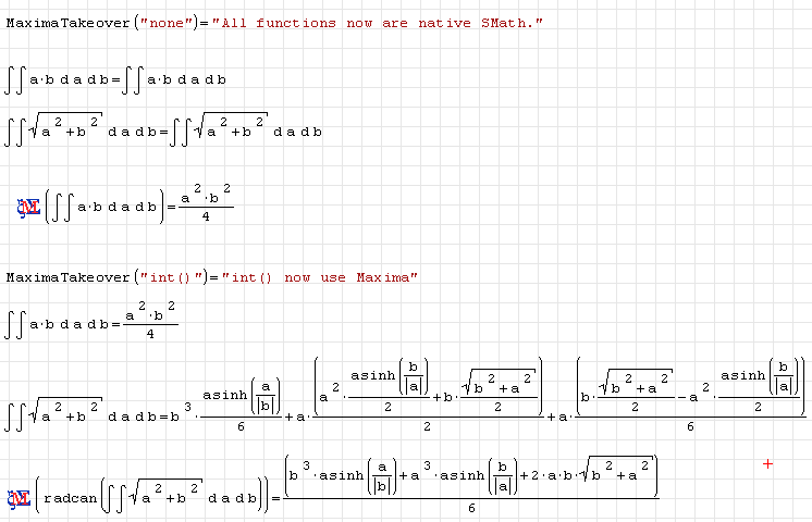

#9 Posted: 2014/10/2 18:37:24
1,353 likes in 2,264 posts.
This is what Maxima does.
Edit: the second integral can be simplified using one of the many Maxima simplification functions.
Davide Carpi 2014/10/2 20:01:00, frapuano 2018/4/9 07:26:00
