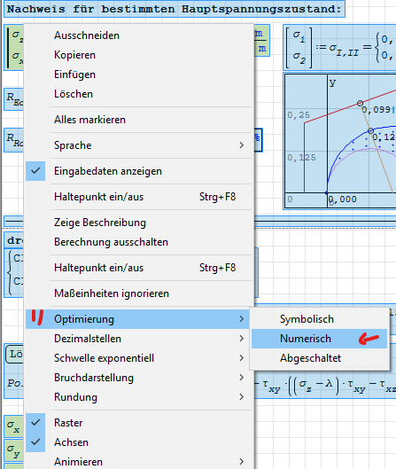

Whenever possible use 'numeric otpimization".
Just select everything (Ctrl A on Windows PC) and choose 'numeric otpimization". (Then eval is not needed necessarily.)
Takes only half a second in my PC. (Adding Ans:Ans, of course.)

MarB--I am really new to SMath. Could you expand a little with perhaps an example of the syntax for Str-A and numeric optimization.
Sorry, on Windows keyboards with English layout 'Ctrl + A' is the correct key to select the whole content of the sheet.
Then select from the context menu Optimization -> numeric.
Thanks. I discovered that and it really helped. For the test case mine ran for about 0.8 seconds. Your computer is faster than mine. Mine is five years old. It even runs for total time from 10-9 to 10-1 seconds with 30 points/decade and number of spatial cells = 10. The runtime for that case is about 2 minutes. If I increase the number of spatial cells to 100 it was still running at 1 hour.
