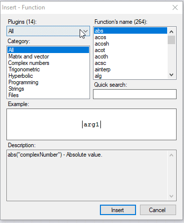

#4 已发布: 2019/3/20 20:05:07
1,443个赞,共2,936个帖子。
go to insert > functions... and play with the plugins dropdown to see what functions are carried by each plugin, also by Special Functions
#5 已发布: 2019/3/20 21:42:25
dio pants
dio pants
16个赞,共180个帖子。
Kinda like this.....
