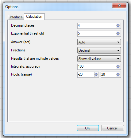

Could you help me with this? I tried to solve this cubic equation
A=solve(x^3+A*x^2+B*x+C=0,x)
where A=5, B=4, C=0, the answer give me only two roots 5 and 0, instead of three. The right answer is -1, 0, 5.
Could you explain me what can I do or what is wrong?

Thank-you Davide
I downloaded the file, but something is wrong because, I only saw two roots
cubic 1
However with other values is ok
cubic2
Robinson

I see... BTW also the cloud version gives 3 roots
Yuo can try to check if something is different in the global settings (Tools > Options... > Calculation)

Now is working. I changed Roots (range).
Thank you for your help

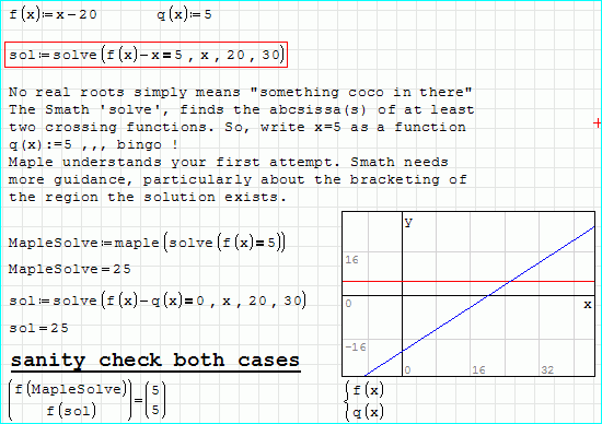

Smath Roots is underdesigned on several counts:
1. The unique Newton-Raphtson does not cope on horizontal/vertical runs of the function
Nothing you can do for two reasons:
1. Smath is very granualar compared to Mathcad 11, 2001i, 8 Pro.
2. Smath does not have TOL, CTOL
3. I figure Smath does not manage Roots because Maxima does not manage.
Suggestion: crack Mathcad 11 root code

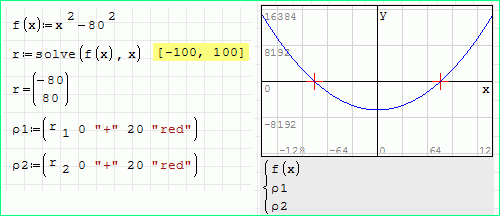

Here are your two plots c/w the roots shown on graph.
I have used the 'Solve Quick' in separate sheets not
to confuse solve[f(x),x] with the two differents
search range. Handling graphs are very easy, just a
matter of adjusting each direction [X,Y] separately.
Your solve with bracketed search range is perfect too !

How do you type the entries in the rho1 and rho2 entries in parentheseis?
Basile

Collab,
Your turmoil is solved. Always plot before you attempt more maths.
