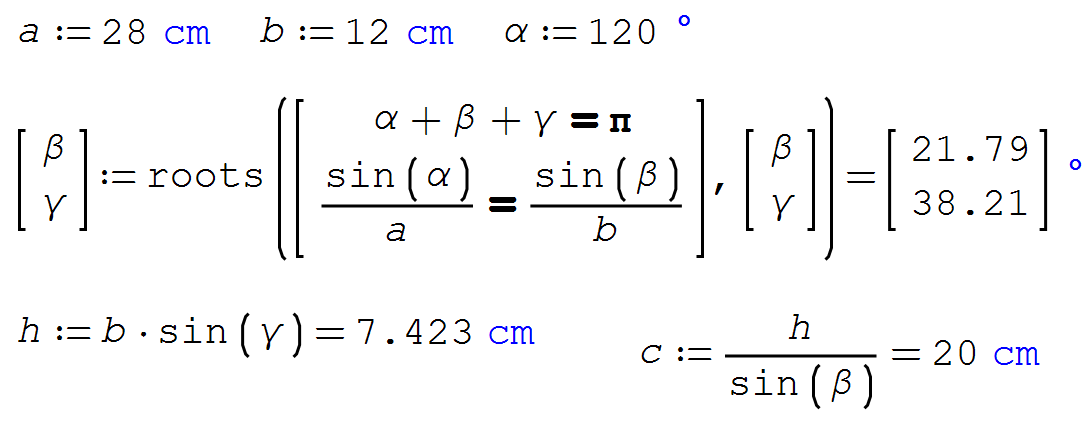

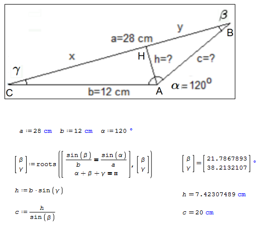

Do you know more simple method?
Natasha-Units.sm (147.18 KiB) downloaded 1306 time(s).
#2 Posted: 2024/9/7 14:51:40
597 likes in 1,377 posts.
FindRoot() can be a simpler method.
You can auto assign guesses to unknowns.
And it can solve with units.
Natasha-Units_findroot.sm (114.03 KiB) downloaded 1318 time(s).
