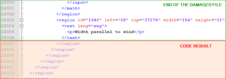

Something can be recovered*, but I can't reproduce the save issue with that file (I have the same error opening your file)...
I suggest you to open a bug in the BTS (I don't know if it is SS-1225 or is a new bug)
*sensible data removed from frontpage
You have to use an advanced notepad (see here). In your case I've added 57 and a at the end of the file, as described in the error message.

That's XML code, you have to begin something and to end it. You may have also if it is not expected that something should be nested inside it (this depends on the tag).
The code of your file was cut off during the last save, so something at the end of file is missing. You can see it because you should see as last tag, but this is missing.
What is needed is to close all the opened tags, then try to open it again.
