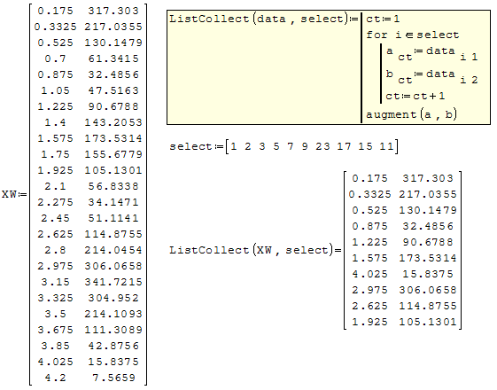

There are several arrays. a=[1;2...4], b=[7;8..10], c=[12;13...15]
How do I combine them so that it turns out as follows - d=[1,2,3,4,7,8,9,10,12,13,14,15]

There is an array a=[1;2...10], I need to exclude several values from it so that it turns out as follows a=[1,2,5,6,7,9,10]
q-1-2.sm (3.71 KiB) downloaded 993 time(s).

thank a lot, all options are excellent!)
WroteThank a lot, all options are excellent !
Appreciated ... more in there ... Jean.
Utilities Matrix Extractors.sm (56.76 KiB) downloaded 984 time(s).

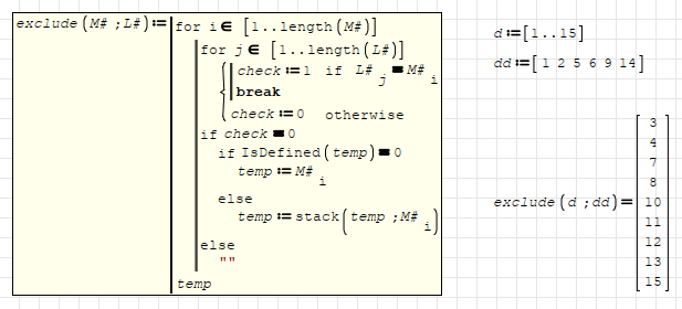

In addition to sergio's answer, you can use an custom exclude function.
It will remove substances of a L# list from master M# list.
exclude.sm (5.92 KiB) downloaded 939 time(s).
