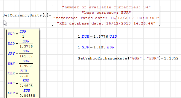

Hi all,
Here there is a plugin to have currencies and exchange rates in SMath Studio.
Infos:
Functions:
  • SetCurrencyUnits(1), SetCurrencyUnits(2): extends SMath Studio with currency units. When an internet connection is available, exchange rates are kept updated using the ECB reference rates (internet connection not required but useful);
    Quote
    The reference rates are usually updated by 3 p.m. C.E.T. They are based on a regular daily concertation procedure between central banks across Europe and worldwide, which normally takes place at 2.15 p.m. CET.
  • GetYahooExchangeRate(2): get a wide set of exchange rates from Yahoo Finance (internet connection required); service discontinued by Yahoo

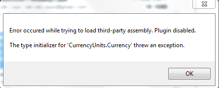

Unfortunately Davide, this does not work for me (Win7 x64). Plugin refuses to install properly.

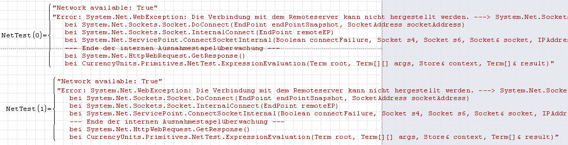

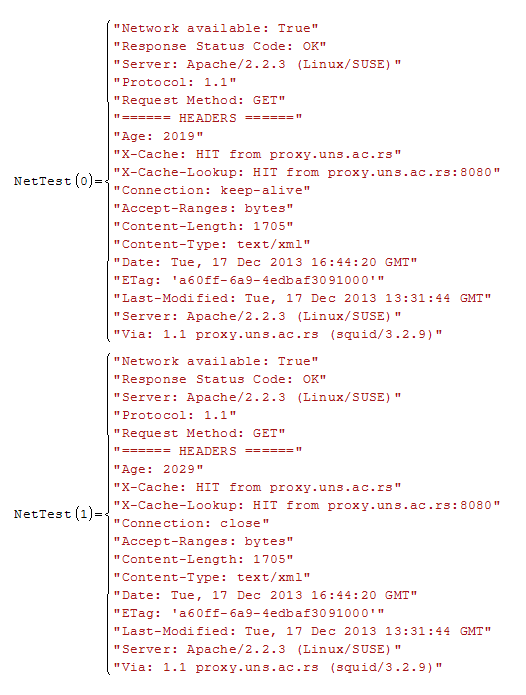

Try again, I've made some changes... If doesn't work try NetTest(0) and NetTest(1) and post a screenshot

very strange... try again with this update; if doens't work got to %APPDATA%\SMath\Debug\CurrencyUnits and post the log file
#7 Posted: 2013/12/17 08:41:16
1,353 likes in 2,264 posts.
The results were overly wide, thus i cut them.
#8 Posted: 2013/12/17 08:41:47
Failed again
Here is the log file
log.txt (1.76 KiB) downloaded 1102 time(s).
#9 Posted: 2013/12/17 11:09:29
1,441 likes in 2,932 posts.
seems a proxy/firewall authorization problem... I suppose that NetTest("http://www.google.com") and NetTest("http://www.google.de") will produce the same results
Failed again
I've made another little modification, could you try again?
#10 Posted: 2013/12/17 13:31:12
It seems that this plugin is not going to install into the Martins' unofficial build. I figured out by the second line of the log file.
I tried it on the official one and it seems to be Ok

#11 Posted: 2013/12/17 13:52:02
thank you Radovan, now I understand
the plugin looks for the files in the %APPDATA% folder, I'll try to fix it
[EDIT] UPDATED: this version should work properly both in the official and the unofficial versions
Radovan Omorjan 2013/12/17 15:08:00

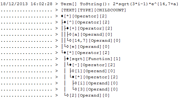

#14 Posted: 2013/12/17 22:14:35
UPDATED
- error handling: LOGs will be placed in the relative "extensions\debug\CurrencyUnits" folder (so the portable version has a portable debug path)
- For developers only: added a log tool to output a Term[] tree representation (see the CurrencyUnits Implementer.cs).
