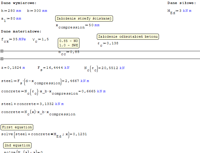

I have an equation, which depends on two other function, which depends on one variable. How can I solve it?
Look at the attached file. smath forum.sm (96.54 KiB)已下载 1314 次。
In general, I have set of two equations:
Fs=Nc(x)
and Fs*(d-x_compression)+Nc(x)*x_b*x_compression=M_Ed
Now, I implemented all funcitons as function of x (x stays for Ec - strain in concrete), but I can easily manipulate compression zone (x_compression) if necessary, as it is also not given as "constant".
At the beginning I define dimensions (b,h,a1) and material (fck, gamma_c, alfa_cc). I also assume compression zone and strain in concrete and I have bending moment M_Ed. Rest (and also x_compression and E_c) are editable/may change and depend on each other.
Could you please tell me what's the easiest way to solve those two equations?
Unfortunatelly, when I am trying to solve(Nc(x)=Fs,x)=0, SMath respond is that x has not been defined.
Any ideas?
BR.
Fs=Nc(x)
Any ideas?
BR.

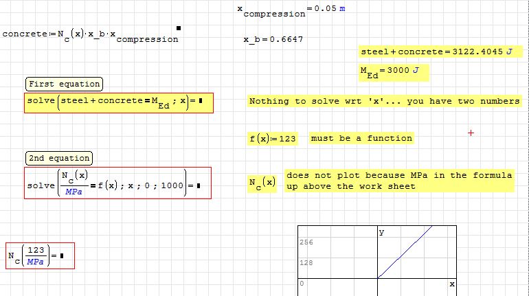

Jean,
thanks for your effort.
You have written:
"nothing to solve as you have two numbers" - not exactly, once you will look into the sum of steel and concrete you may see there Nc(Ec) - Ec is variable.
"f(x) must be a function" - isn't f(x)=123 a function? Still, I don't have any results. I would like to know at what argument Nc(x) is equal to Fs (Nc(x)=16.37, as then I may estimate strains in concrete. I don't know maybe you see a result? I have attached photo.

WroteCould you take one more look at it?
Yes, and the answer is that there is no automatic solution.
Why ? Because the base "concrete(x)" is not a function,
only a discontinuous function, incompatible to the solver(s).
Done manually at the end of the work sheet.
Maybe "Dichotomy" is suitable ?
smath forum.sm (112.07 KiB)已下载 1342 次。
... "Dichotomy" solves nicely !
Solves for 'x' in "concrete(x)" for any value(s) in MEd(x)
Is it done as expected ? Your stuff is not my cup of tea !
smath forum.sm (116.76 KiB)已下载 1374 次。

Can we use Newton-Raphson method instead of Dichotomy for example?
WroteCan we use Newton-Raphson method instead of Dichotomy for example?
Answer is : NO
MED(x) is a constant , Newton-Raphson supports only functions
Dichotomy supports MED(x) defined as a constant, i.e: it
supports "fake function" as well as the 'solve block'
In your document, 'solve' fails because of the unit system.
... rootsecant fails as well.
Med(x) in future may be function, not only constant. Will dichtomy be enough then to solve it?
From what I understand N-R may be applicable then, also?
Could you give me mathematical definition of dichotomy (it would be best if you can demonstrate it on that particular example)?
Then, you have stated something in pink background at the end of document. Was it check? You have defined values Epsilon, a and b - and I would like to know why.
The RootSecant & NewtonRaphson both need true functions.
Differently, "Dichotomy" takes a constant defined as a fake function.
In dichotomy: epsilon is the test for the convergence towards the solution,
solution desired at "epsilon accuracy". The while loop keeps refining the
solution at each step... more in green.
smath forum.sm (132.91 KiB)已下载 1328 次。
