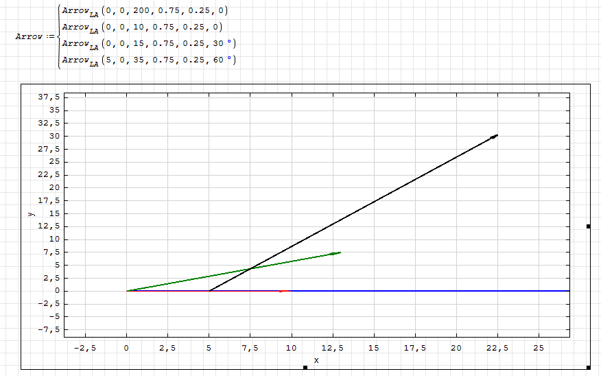

Scaling the vectors to always be one but will loose real valuesSMath-1.PNG.
Any good idea?
Is there a way to auto-scale the 2D plot or X-Y plot?

#10 Posted: 2019/5/24 15:19:13
1,544 likes in 1,859 posts.
As I said before:
How about a simple arrow?
I do not know how to do it better. The arrow should look good in different scales and in its own size.
#11 Posted: 2019/5/24 17:35:33
Any good idea?
One of the vectors is out of the visual plane.
None of the quick plot or X_Y plot can be made X, Y directions scalable
similar to Mathcad 11 ... to me: useless.
From an original X_Y plot creation, stretch by handles respect aspect ratio.
If you modify the X, Y directions [max/min], apply close enough HL, HW ratio.
Page2-error (1).sm (11.66 KiB) downloaded 1098 time(s).

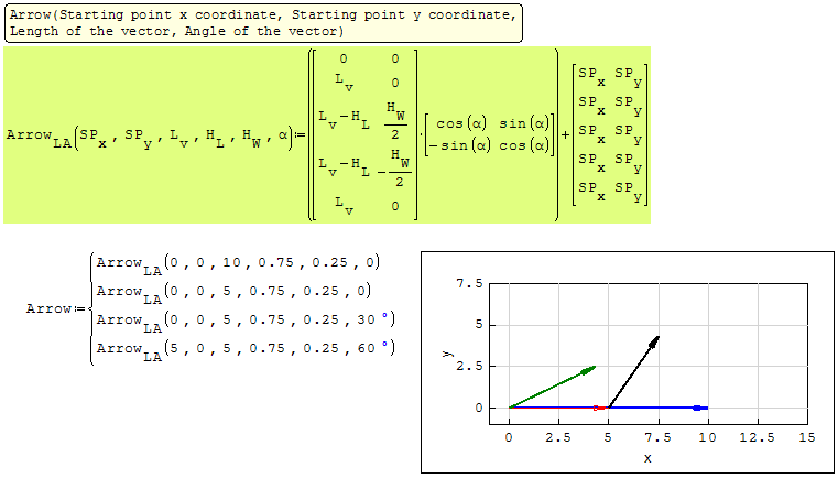

#12 Posted: 2019/5/24 22:44:11
Fridel Selitsky
Fridel Selitsky
520 likes in 451 posts.
Another kind of arrow.
Arrow.sm (5.46 KiB) downloaded 883 time(s).
3 users liked this post

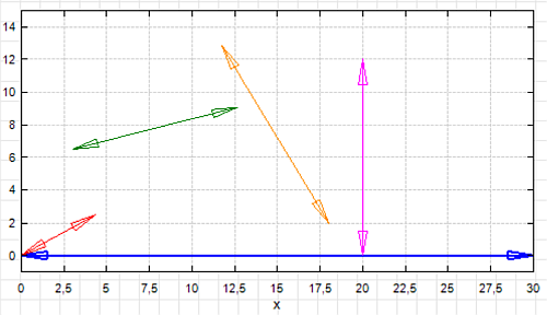

#13 Posted: 2019/5/25 21:24:37
NDTM Amarasekera
NDTM Amarasekera
130 likes in 352 posts.
More elegant arrows proposed.
With both arrow heads, based on Jean's method.
Thank you Jean.
Both Arrows.sm (30.49 KiB) downloaded 899 time(s).
#14 Posted: 2019/5/26 00:52:40
Basile
Basile
8 likes in 172 posts.
Why I am getting errors when load your file?
The latest Stable: SMath Studio 0.99.7030 (01 April 2019)
At the end I am able to open the file.
I do the same with two arrows 2π apart, but yours is more elegant.
