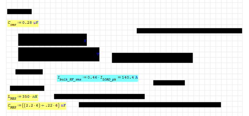

#13 Posted: 2019/11/15 11:34:05
Ruben Sidranski
Ruben Sidranski
17 likes in 465 posts.
I have the same issue (0.99.7251.32800) with the acoustic file on https://en.smath.com/forum/yaf_postsm59725_Summation-of-log-functions.aspx#post59725

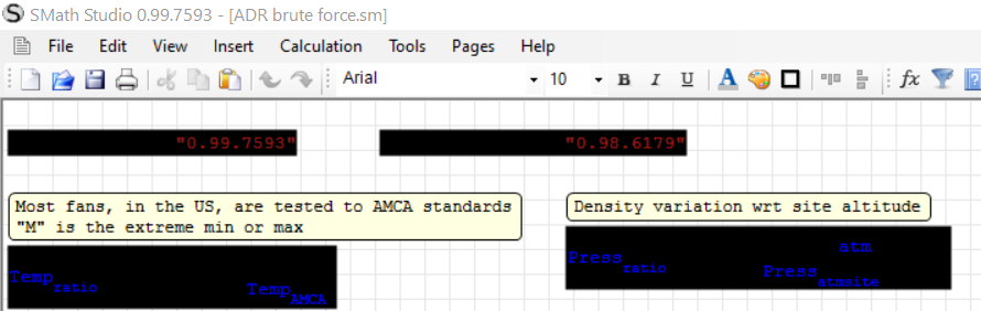

#14 Posted: 2021/1/11 12:45:17
Ruben Sidranski
Ruben Sidranski
Bug is still present in Jean's file. Funny thing is this was MY work. His items came were hit or miss. I'm working off of portable version. See file post #3
